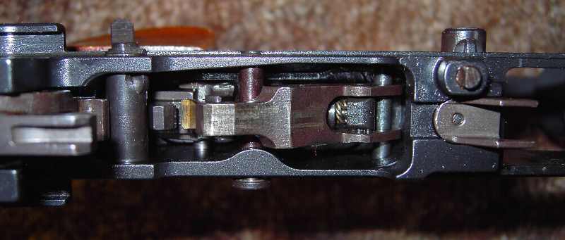

I installed the rate reducer. I know it's not needed. There was no fitting or problems. I used a RT lower for the build.
https://i.postimg.cc/157KpdC1/Tk-1-lower012.jpg
They kind of over engineered the rate reducer.
