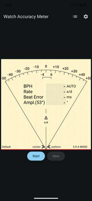

You can use a pc or phone app with a microphone.
1/19/2026 9:56:26 PM EDT
https://i.ibb.co/FbQqvGYM/Screenshot-20260118-145335.png
Thanks!
I’ll check it out.

The amplitude is a key way to determine if your watch needs service. If the amplitude range is good, it probably only needs regulation.
