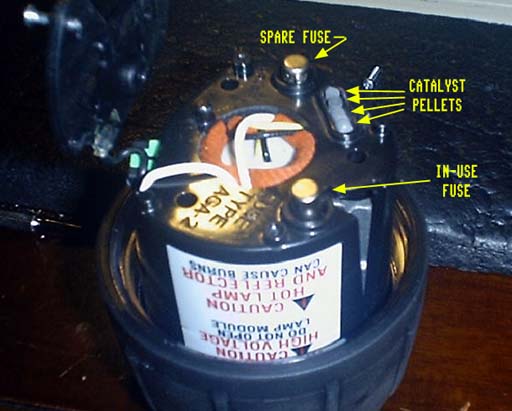

I recently bought a pair of Underwater Kinetics Light Cannon 100 HID dive lights. One worked, but the other didn’t so I tried swapping around the fuses and bulbs trying to troubleshoot it. I unknowingly spilled the little gray catalyst pellets out and now can’t figure out how they are supposed to be placed in their slot. No matter what way I try I can’t get the light that was working to work again. I’ll try emailing the manufacturer also, but wanted to check here anyway. Thanks for any help.

You are probably aware, but don't be tempted to glue the pellets in place.  They need to be exposed completely to absorb hydrogen.
Hopefully both bulbs aren't toast.

I’m actually bidding on a mint condition uk 600, I like those huge old lights. I’m going to try new batteries and see if that works, the fuses look good, but I’m also going to get new ones. I’ll see what it would cost to send them in for repair or new bulbs. I found one of the fuses was blown so it very well could be the bulb. I’m half tempted to see if the new led module will fit in the body and just upgrade them.
