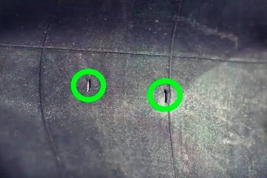

What's snakebite?  Is that when the tire kicks sideways when you hit a pebble?

Thats when the tire deforms too much hitting a sharp edge like rock or curb causing the rim to puncture the tire in two places, looks like a snake bite.
