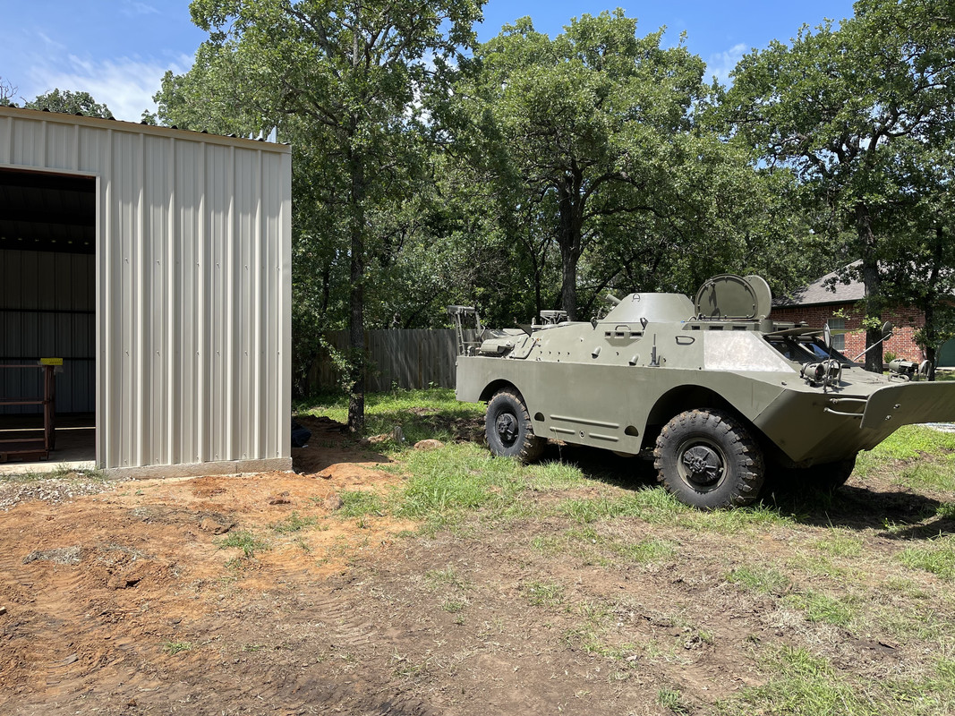

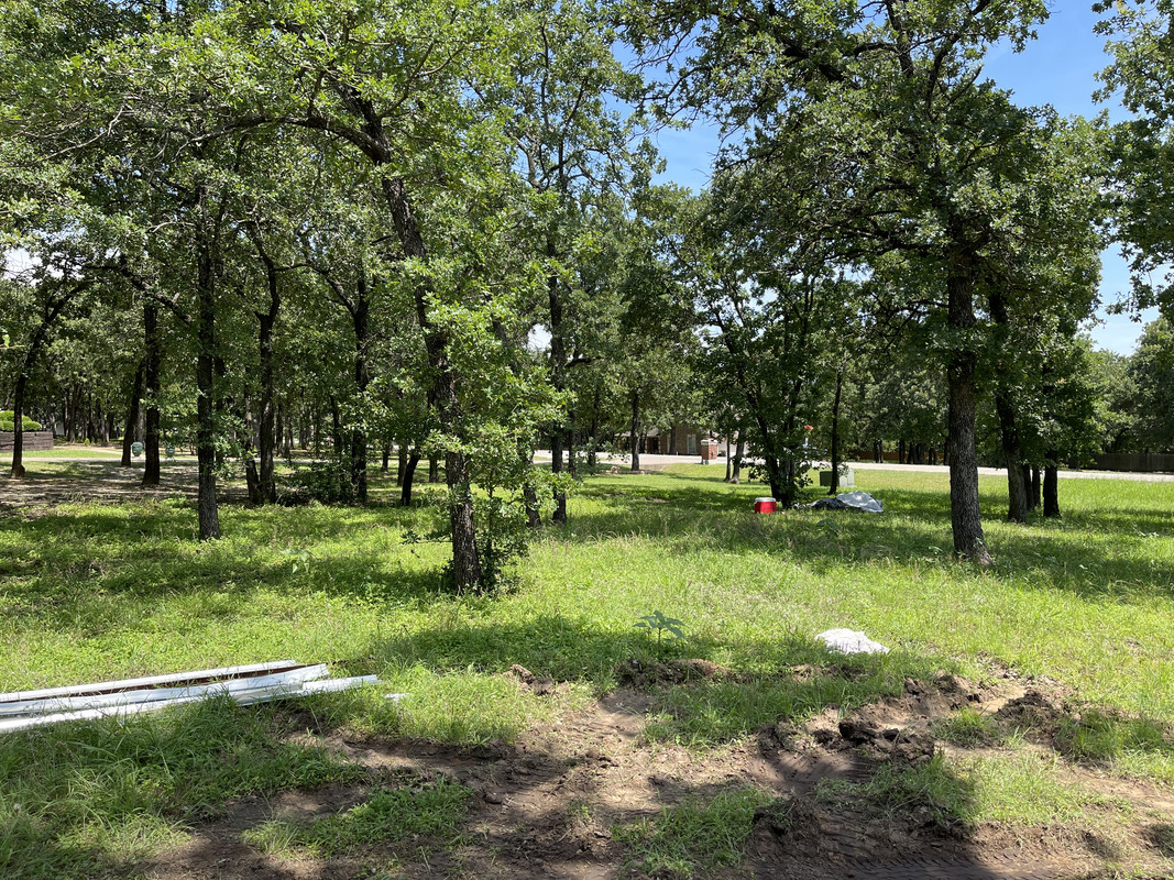

Where it was
Where it is now.
Ran it for about 45 minutes and let it get to operating temperature. It had been sitting for a few weeks totally dead.

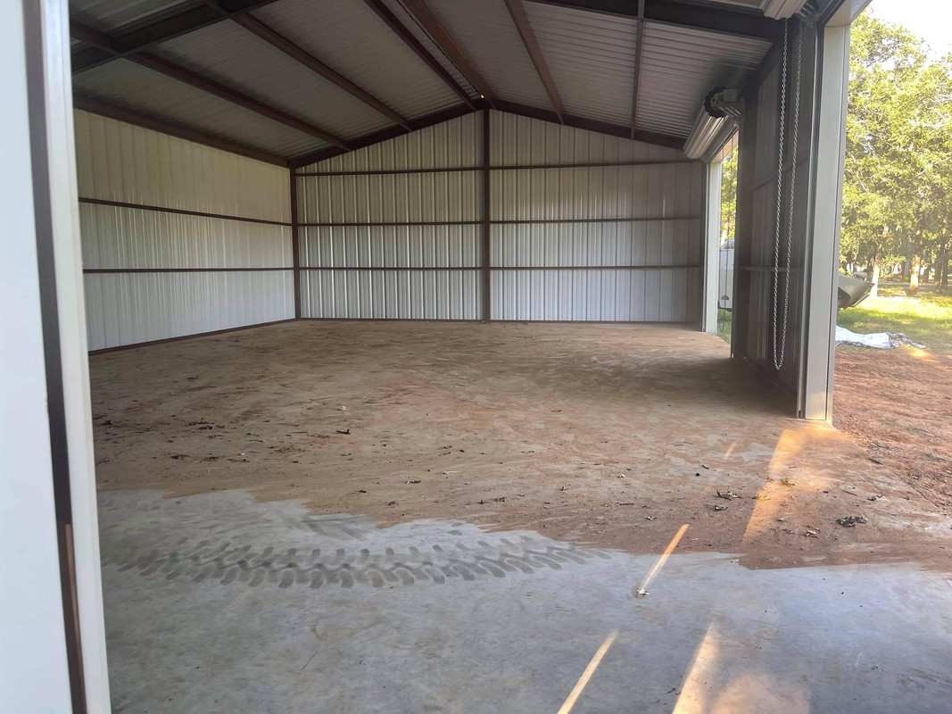

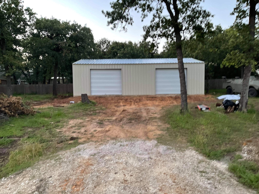

They were supposed to finish up the shop today but they didn’t come by. Still need to install the center roof section, doors, and trim exterior panels
6/15/2021 11:19:56 PM EDT
All done beyond some minor things

I love your shop.
I am only modestly concerned by the hole in the roof. I figure it probably looks worse than it is.

What hole?

Originally Posted By fadedsun:
What hole?
Originally Posted By ASUsax:
I love your shop.
What hole?
At the peak right at the end wall.
6/18/2021 6:38:42 PM EDT
Should be a vent.
Should be a vent.
Should be a vent.
That makes a lot more sense.

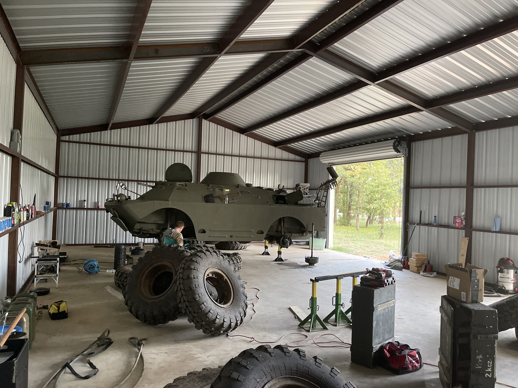

Progress today

Impact driver to remove lug nuts? No.
2 Ben power to remove stuck lug nuts? Yes

So are you replacing the entire brake system part by part at this point?
Well, isn't this a fine kettle of fish.
7/3/2021 12:25:58 AM EDT
Replacing, no.
Inspecting flushing and probably replacing a few parts, yes. Axle seal too.
It is so much nicer working in an actual shop instead of outside.
7/3/2021 11:16:43 AM EDT
No trying to see why the shoes will not completely retract

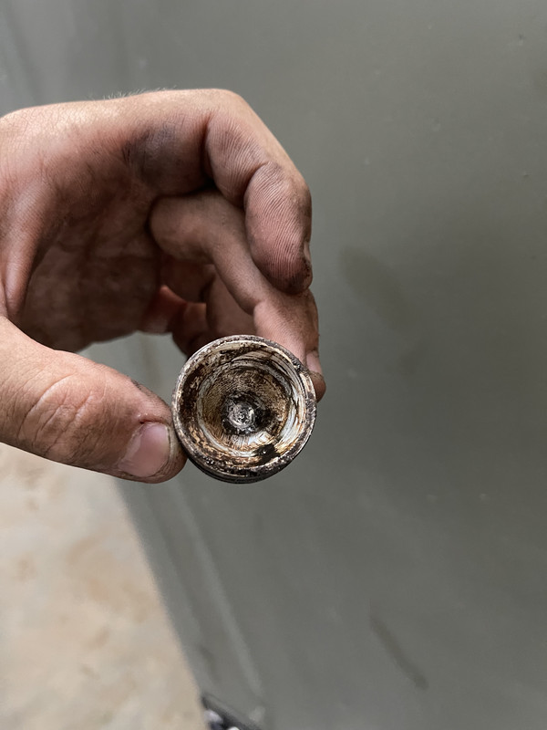

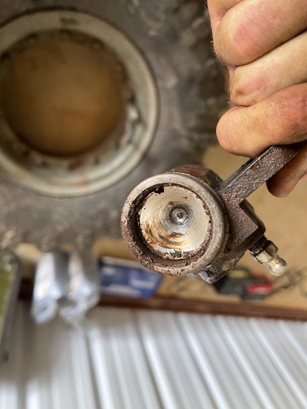

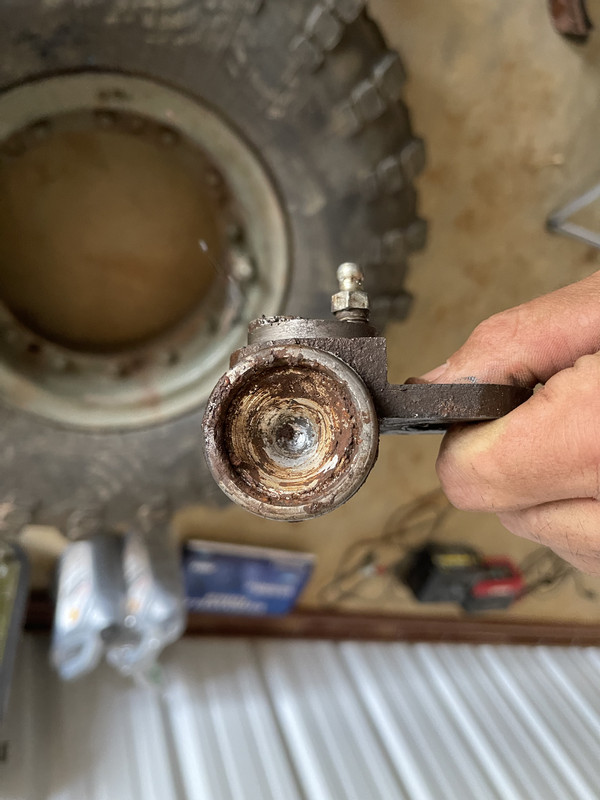

7/25/2021 7:55:37 PM EDT

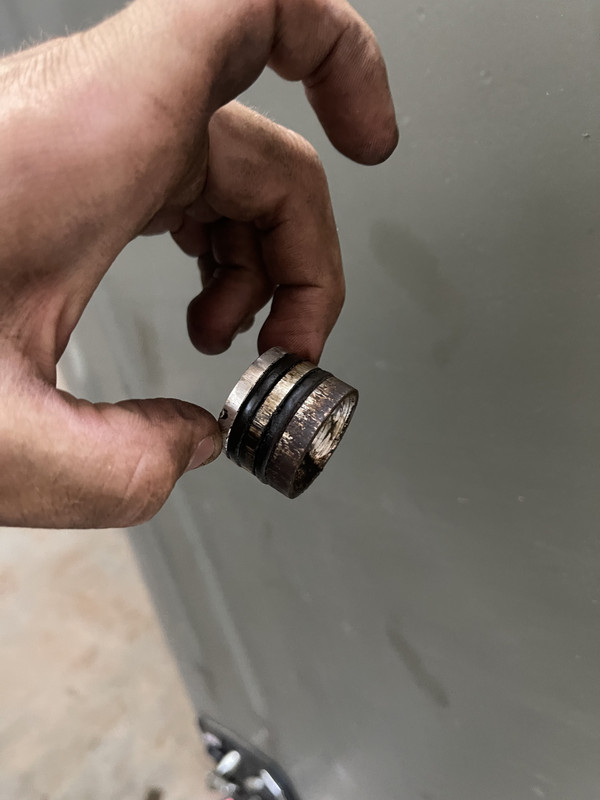

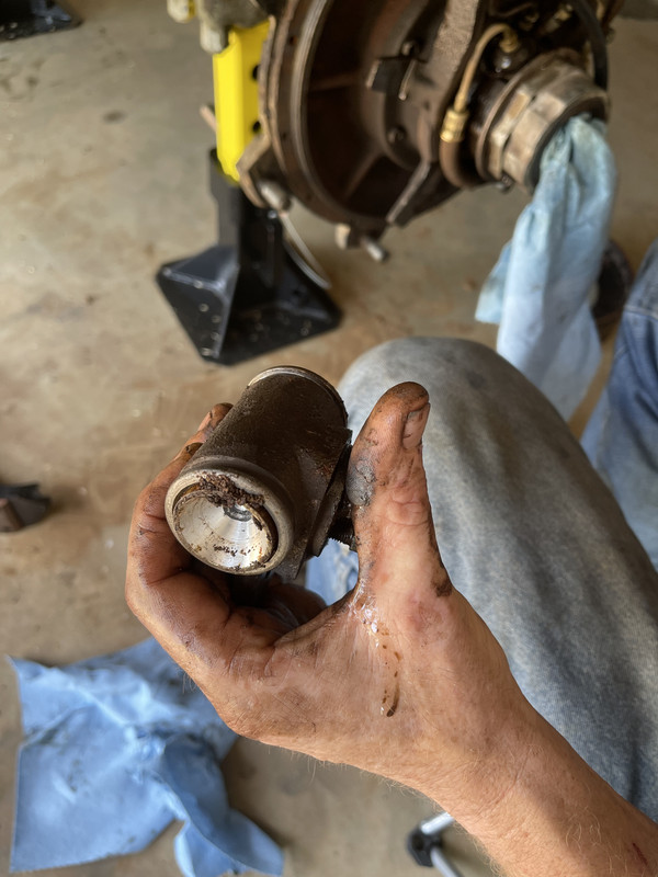

Pretty nasty.
7/25/2021 8:33:20 PM EDT
Is that the issue w/ the brakes?
7/25/2021 10:25:32 PM EDT
Could be.
Won’t know until we have the sucker together tomorrow
And bled to see if it works.
7/25/2021 10:35:05 PM EDT
Seems like it. The wheel cylinders wouldn't retract.

7/26/2021 8:33:56 AM EDT
That is pretty nasty. I am guessing stopping has not been good even for the previous owners

7/26/2021 9:26:00 PM EDT
Yeah brakes have been the biggest hold up so far. The wheel cylinders wouldn't completely retract and the brake drag was bad.
