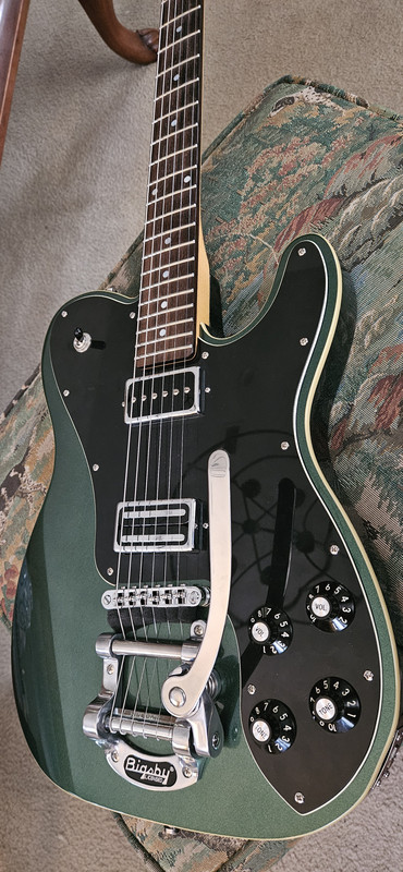

Installed the Butchie Bar ($40) on my Bigsby today.  If you order one of these, read carefully:
Outer pin measurement of 47mm takes the "all US Bigsby Models" and 50mm spacing takes "all Licensed Bigsby models.". Mine is a licensed Bigsby which means imported and it fit the one for US Bigsby models.  The owner was nice enough to send me the 2nd one to try when 1st one didn't fit. This is a really well finished and designed device, with great chrome work.  Probably not as quick for string changes as the Vibramate String Spoiler UNLESS you are changing a complete set as you can string up the Butchie Bar before placing it on the main bar of the Bigsby and pull all the strings around the tension bar at once. It is much easier to restring than a stock Bigsby. It's barely noticeable once installed. US product manufactured in NJ. I highly recommend this if you want to make string changes easier.  If you like the stock setup, the StringRay($10?) is pretty handy and cheap to help keep the ball ends seated.
Only issue I had was that a couple ball ends didn't want to seat when string was tightened but a little nudging with the end of a plastic pen (to prevent marring the paint) popped them into the countersink easily.

Also put some foam cut in a wedge under my pickups since the neck angle puts the pickups at an odd angle with the strings, making one coil slightly farther from the strings.  I'll have to redo the one for the neck pickup later as it didn't cant the pickup enough.

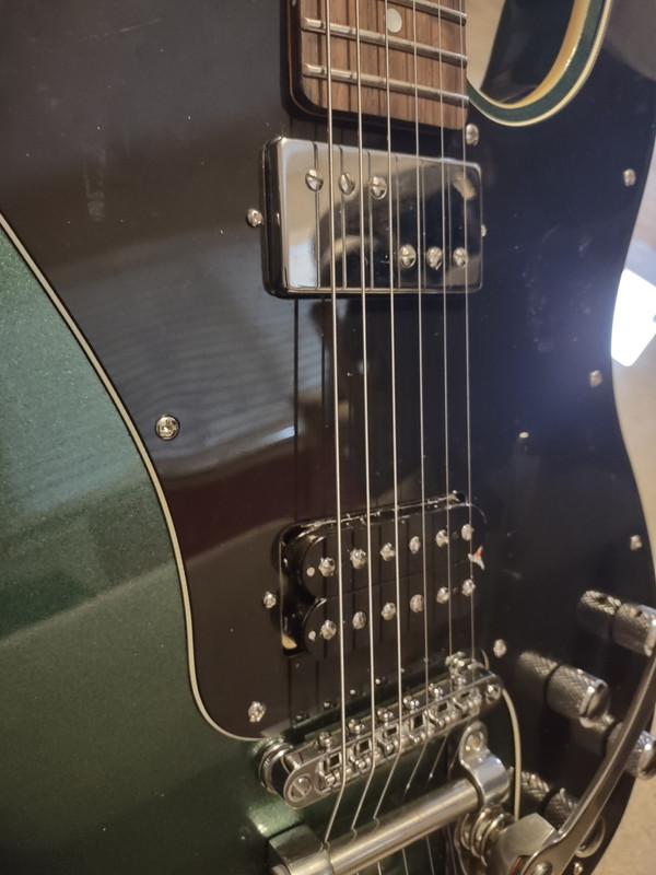

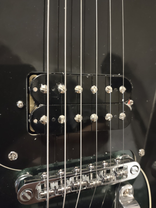

New mod to my Schecter PT Fastback IIB... I was curious what was under the
hood of fake WRHB covers. Turns out all the poles are screws and the ones hidden were screwed way in to clear the covers...which isn't a good thing. Wax potting was pretty poor which explains some of the squeal I was getting with higher gain amps. Covers were soldered on with something that my 700 degree soldering iron wouldn't even melt so ended up cutting the cover off with a Dremel disc. The covers were brass. Still working at getting some of the wax off the pickup but results as you'd expect with cover removed. More clarity, handles high gain with less mud. I was considering replacing this pickup with a Duncan Distortion but this will hold me off.

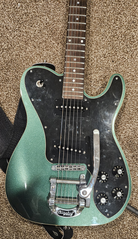

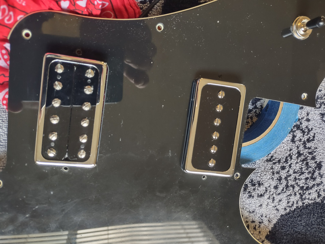

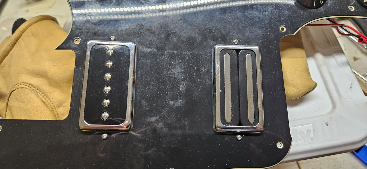

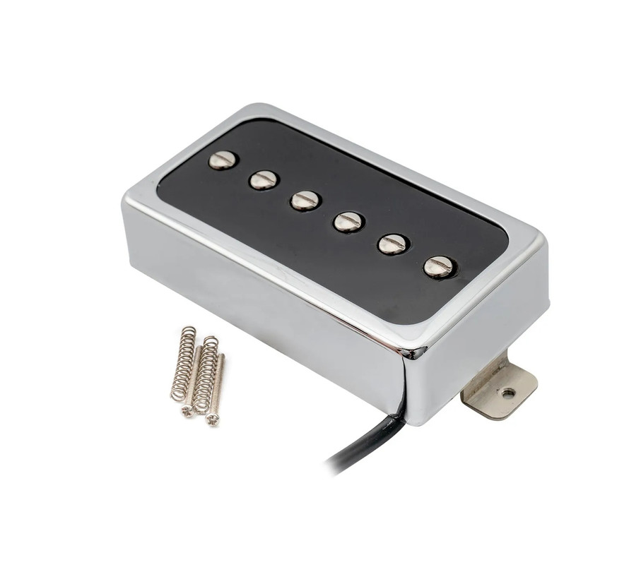

Next up, I'm giving my Schecter a more Duesenberg look, with open pickup covers.  Ordered a nickel silver ring for my bridge PU and an Artec neck humbucker size P90 (8k) that has an open cover...this look:
On this guitar...
From what I can tell, a P90 should do just fine with the 500k pots and .022 cap that's already in there for the stock humbucker. Always found Artec pickups to be hidden gems:

After the slow boat from China arrived with my Artec pickup...looks like Musiclily out of Shenzhen is now the distributor for Artec, which I don't fully comprehend since they are supposed to be a South Korean company and I thought I'd be getting SK manufactured pickups.... The mockup looks good anyway...

Done with the pickup dress-up and swap.  At least it looks good, haven't had a chance to crank an amp up and check the new pickup out yet. I was having trouble with the OEM unbranded toggle also so upgraded that to a Switchcraft while I had the soldering iron warm

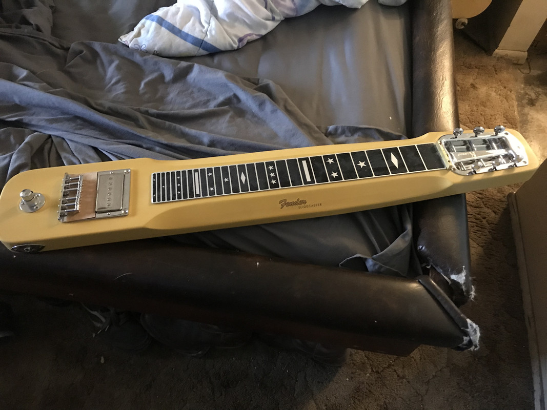

I’ve been working on this lap steel build.
I’ve never played one, but I got a wild hair one day to get one, then decided to just make my own.
How hard can it be?Mock up
Link Posted: 9/22/2023 3:40:00 PM EST
Got it 1000 grit flat sanded. I’m going to go over it with 1500, 2000, then start polishing.
