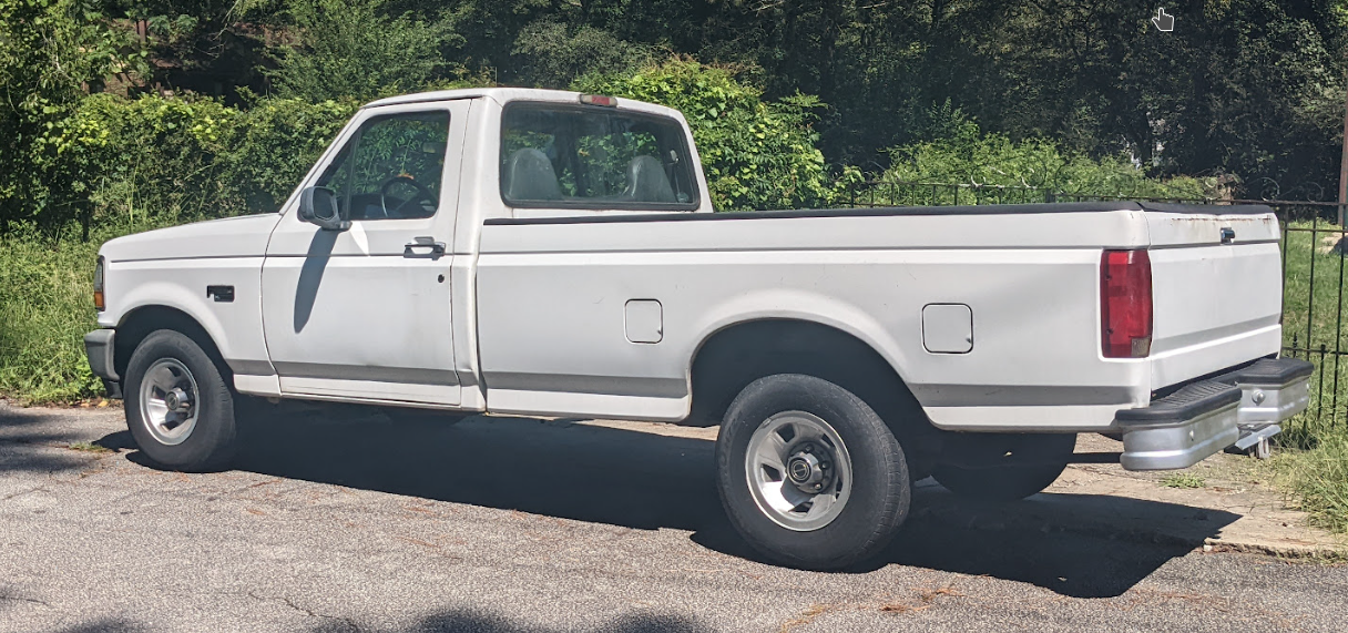

Picked up my dad’s 94 f150 last weekend.
Got the outside cleaned up. I love this body style of fords.
He had three mid 90’s models. Sold his other 4wd. His wife of 6 years decided her son needed his 93 2wd. (Pretty weird)
6/20/2026 10:46:57 PM EDT

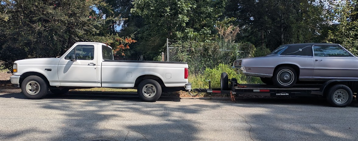

Sold it to my FIL for $1 when he had some shit luck ( he was a great man). Got  divorced and he died a couple of years later. Think I ever got a call about buying the truck back? Pics look better than in person. Clear coat was coming off. But it was a solid truck.

https://www.ar15.com/media/mediaFiles/320646/IMG_0011-3782588.jpg
You should have left your name with his on the title.  Joint custody!
Originally Posted By ScottsGT:
Lessons learned.
Beautiful pickup man!
