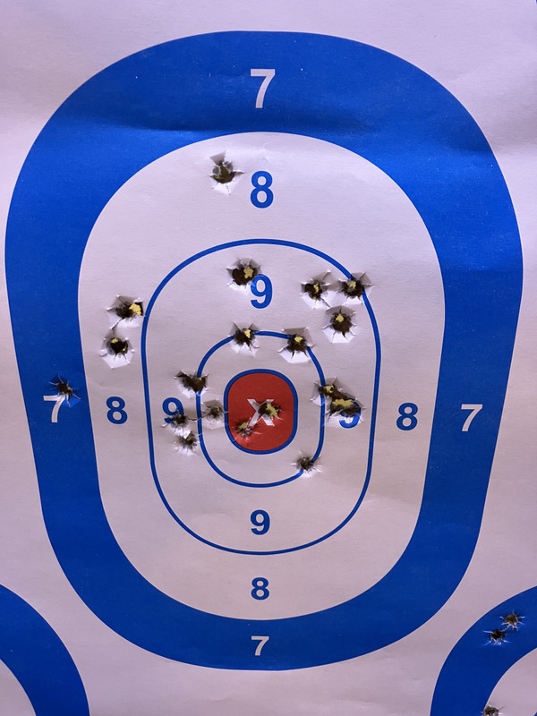

Funny you should mention that.  I shot a 20 shot group from a rest from one of my guns (M9A4) and got 10 shots within 2.25", 19 shots within 5.5", and the 20th shot opened it up to an 8 inch "group".  Very disappointing. (See my Osight parallax thread.)
This was just random cheap 115 grain 9mm ball ammo.  But still, I can shoot a 2" ten shot group with cheap bulk .22lr out of my MkII from the same sandbags without even trying too hard.  I'd be very happy with 10 shots of 9mm bulk ammo inside 2" at 25 yards.  But with an 8" group at that range, that's a miss on some of the farther steel targets at the local matches, especially offhand and in a hurry.

I went to the range today with my disappointingly inaccurate M9A4.  I've been chasing whatever the problem is on this gun for months,  trying to eliminate potential causes.  I've replaced the locking block, which has helped with barrel lockup.  I've also ordered a new (hopefully better fitting) optics plate.  I thought perhaps it was a parallax issue with the Osight, but at 25 yards moving my head around, the dot appeared to be pretty static on the target.
This is the best I could do with WWB 115gr FMJ with the factory optics plate.  15 rounds (one magazine) at 25 yards produced a 3.69" group.  I'd be plenty happy with this for a $300 plastic gun.  But a $1200 Beretta should do better.
I can shoot a 2" group with my beater Ruger MkII and Federal bulk .22 ammo at 25 yards without really trying super hard, so I don't think my technique is the problem.
There is a matter of the twist rate being a little better suited to 124gr ammo, but that shouldn't account for such a large error.
I'd like to see a group half this size, but I think I'm going to have to be satisfied with this.  I'll try a different M9A4 and a Holosun when the Dlah plate shows up.
In any case, I went through the same sight-in process but instead of supporting the gun direcly, I used a 2 handed grip and supported my hands with the sandbags, and it actually seems to be a little better than supporting the gun directly with the bags.

4/4/2026 4:52:31 PM EDT
15 yds, off hand
