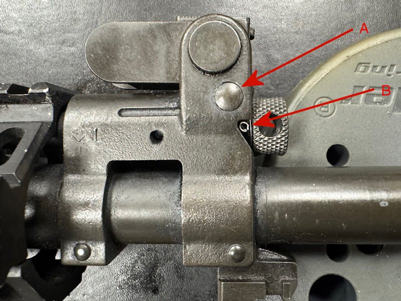

I have a Colt LE6940P Piston Carbine that came from a police department.  It's pretty dirty, so I want to clean it up.  Unfortunately, I'm having trouble removing the gas piston.  It appears to have a retaining pin that holds the assembly in place.  It's marked A in the picture below.  I tried tapping on the opposite side shown, but it doesn't budge.  Additionally, there's a roll pin that appears like it would hold the assembly in place even if the retaining pin was removed.  It's marked B in the picture below.  This of course begs the question.  Why would they have both a retaining pin to allow for disassembly and a roll pin to prevent it?  What am I missing here?
2/8/2026 1:51:56 PM EDT
https://www.ar15.com/forums/ar-15/Colt_6940P__Piston_Parts_Pics/126-604811/
this old thread looks like it will help.
2/8/2026 2:08:43 PM EDT
That's exactly what I needed.  Thank you very much.

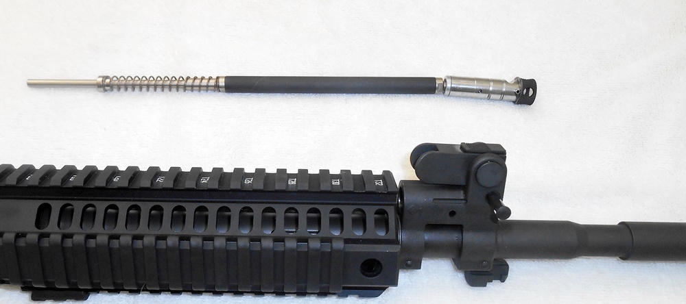

2/9/2026 8:33:01 AM EDT
It's probably just carbon locked.  My 6940P when new:
