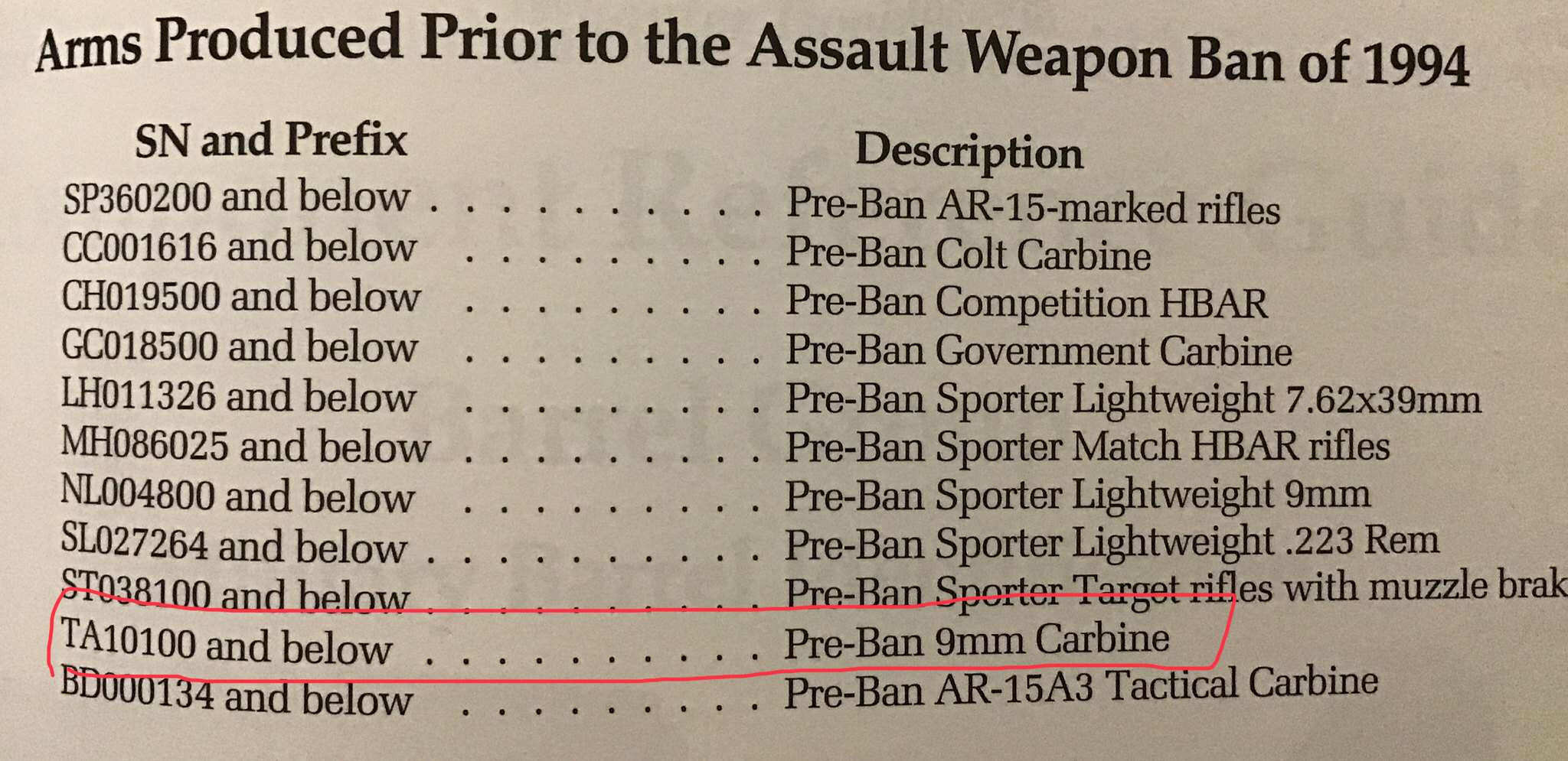

I see they still use the LTA prefix. Hank Tatro was the primary engineer of the 9mm Colts and the semi auto ones are prefixed TA for pre September ‘94 and LTA after September ‘94. I think the select-fire models are HTA prefixed to honor his work I guess. Have the really made only 9000 since 1994? LOL IMG_5659 by SmëgHead, on Flickr" />
