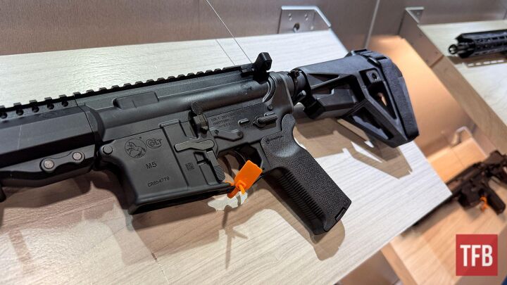

Looks like M5 uppers in 11.5, 14.5 and 16, a 14.5 M4 upper, and an 11.5 IAR upper.
https://scatteredshots.com/2026/01/20/new-colt-product-at-shot-show-2026/
11.5 pistol variants of the EPR II and M5.
https://scatteredshots.com/2026/01/21/more-rifles-from-colt-at-shot/

M5 pistols and SBRs in the commercial display makes me happy. More closeups at the link.
https://scatteredshots.com/2026/01/22/colt-shot-show-commercial-rifle-display/

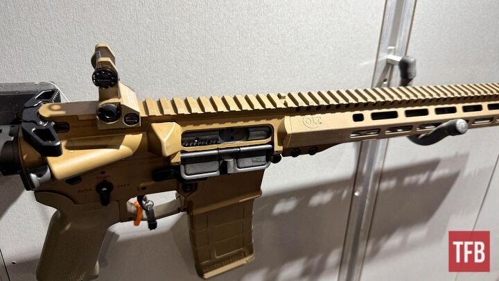

https://www.thefirearmblog.com/blog/shot-2026-colt-ar-pistols-two-new-5-56-skus-with-lower-variants-44825875
Apparently the pistols will just be marked M4/M5, not M4/M5 Carbine. Probably a good thing considering how stressed out people have gotten over whether a lower can be made into a pistol.
They also had an FDE M5 on display.

I wish they would have added a P/W 14.4” M5 to the lineup.
1/29/2026 7:31:13 PM EDT
I like FDE, but that appears to be Cerakote. I'd much rather have it anodized
1/29/2026 7:34:31 PM EDT
Here's what they showed off to our guys
EPR & M4/M5 Braced Pistol | Colt | SHOT Show 2026
I saw a LE catalog that said FDE could be available in Cera or Ano finish.  No idea if you would actually be able to get your hands on one or not.  Maybe would be a minimum contract order.
1/31/2026 11:09:23 AM EDT
It is anodized.
2/4/2026 9:03:44 PM EDT
[Last Edit: AL25][Edited] [#20]
Originally Posted By Minuteman1636:
It is anodized.
I believe you, but those pictures make it look painted. It doesn't look anything like the finish on the Colt Canada C20, which is also anodized. The rail does look like the finish on the C20.

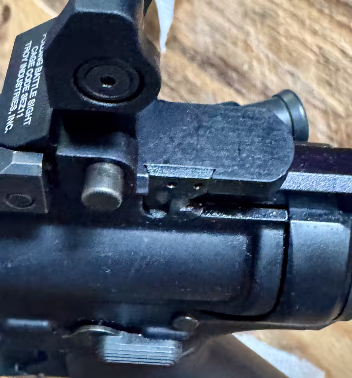

My M5 10.3" upper did not have the steel insert. Are these steel inserts to be expected going forward now. Mine came from AU.

2/16/2026 8:11:39 AM EDT
Interesting.  I bought my upper from AU last summer.  Ordered July 28th.  I wonder if it was a running change.
That must be new, I've never seen it on a Colt rifle or upper. My newest is 2024 production FWIW.
