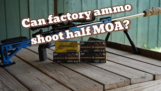

Testing of the Berger 77 OTM, FGMM 69smk, FGMM 73gr Berger OTM and FGMM 77smk. Spoiler…they all shot well, with some being exceptional. ![]() 223 Precision Ammo Shootout Pt. 2, FGMM 69gr SMK, 73gr Berger OTM, 77gr SMK and Berger 77gr OTM |

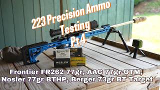

Pt. 4 Berger 73gr BT Target Nosler 77gr BTHP Frontier FR262 77gr AAC 77gr OTM ![]() 223 Precision Ammo Testing; Part 4 (IMPRESSIVE RESULTS) |
