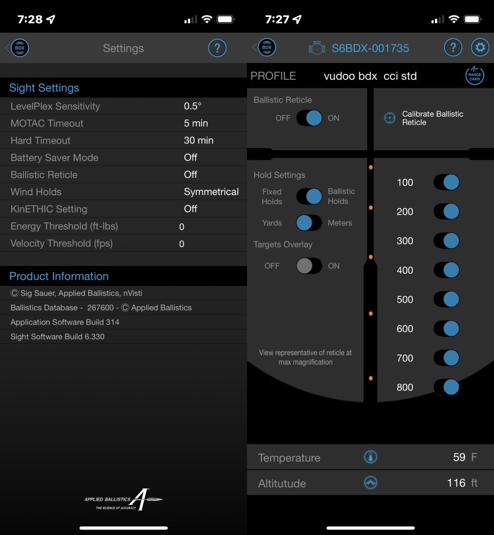

The Sight Settings Selection Screens in the Sig BDX App
Just as with the rangefinder, the BDX scope can be used in a variety of different ways with the use of a BDX rangefinder and the BDX app or without. If the user does not possess a BDX rangefinder, the BDX scope can be configured in three different simple ways. The little instruction pamphlet that comes with the scope explains to the user how to set the scope to display dots every 5moa or how to display them to represent the drop at 100yd increments for one of the pre-programed ballistic groups. This can be done without either a rangefinder or the app. Once you add the free smartphone app to the equation, you then gain the option to display dots at 100yd increments for a user created ballistic profile, and even to true the muzzle velocity of that profile in the field. This comes down to being able to make what amounts to a custom reticle for your particular rifle and cartridge. This is neat in that it gives some options for using a BDX scope outside of the full BDX system. Really though, I think few people are going to buy a BDX scope for anything except going with the full rock‘n’roll BDX system.
That full rock ‘n’ roll BDX system involves pairing a BDX rangefinder and scope with the BDX smartphone app and with each other. This is super easy. You download the BDX app to your smartphone, open it up, and the options to pair a scope and rangefinder are right there on the home screen. Clicking one them walks you thorough the process. After that, the custom profiles tab gives you the option to create a ballistic profile for your specific rifle and ammunition. For the novice, this can be as simple as typing in the information off of the ammunition box for velocity and either looking up the G1 or G7 value of that ammunition in the BDX app library or typing in the one printed on the box. (Given the choice, use the one in the library:  AB's measurements of BC are better than those ammo companies will give you.) BDX users with one of the rangefinders that includes AB elite will also often have the option of looking up a "custom curve" drag model, which is basically a model based on measurements of that actual bullet made by the AB guys instead of applying what amounts to a scaling factor to the curve made by the reference G7 or G1 bullets. Essentially, the "custom curve" is likely to require less messing with on your part to get it to fit well with the actual real world behavior of your ammunition out of your rifle. In my experience so far, "custom curves" are frequently good to the 10th mil with no truing out until you hit transonic, not an experience I ever had in the past with G1 and G7 based ballistic models.
Typing this all out makes it sounds much more complicated than it is. What it really comes down to is downloading the app to your phone, and following its instructions to fill in a couple boxes with the information printed on the ammunition box. It's super simple and you don't have to understand very much of what is going on to get  pretty good solutions (in the case of Elite, likely very good solutions) showing up right there on your scope as dots to put on the target where you want to hit. Range target, put the dot that shows up on your scope where you want the bullet to go, don't forget about the wind, pull trigger. Sig calls it "connecting the dot."
