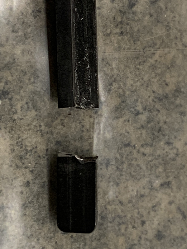

I’ll start with my first one, as there will be more to come.  I picked up a Harrison Gunworks version because it was the lowest cost.  It was put in a Maadi with a Tapco trigger.  The fitting took about three to four hours.  It’s a little tedious, but I don’t want to have to add steel back to parts.  The metal removal for this was on the trigger.  Other parts were polished with a sanding drum and the material removed would be measured with a micrometer.
I got it working the way it should and took it out to test.  I left it tight thinking it would wear in when firing, but that’s not the case.  I had to do a little more fitting and polishing.
Range trip two was a success right up to when it was not.  The trip bar broke during mag number two.
I contacted the owner afterwards and asked about a replacement hoping that it could be warranted.  After several emails I was told replacement parts would be made available for purchase in the future.  I was going to fuse it back together, but it’s a little too cold right now.
I ordered a second FRT from Deez Nutz Tactical to try out in the interim.  I’ll compare the two and report back on that once it arrives.  I’m also looking at getting a MARS from Alfa Tactical, as it’s a different type.  It’s a little more expensive, but I want to make a comparison of different types with installation and durability to share with those who are interested.
More to follow.

If its printed steel iit'll never weld
1/19/2025 7:40:54 PM EDT
[Last Edit: Dakota_Don][Edited] [#2]
It’s machined and hardened.  Sintered metal wouldn’t hold up to two rounds, let alone almost two mags.  The second set from DNT looks identical in the pictures.  I’m planning on measuring both to verify that.
1/19/2025 9:09:43 PM EDT
[Last Edit: 71Camaro427][Edited] [#3]
I have a couple of printed stainless sets  in AK's with hundreds of rounds through them without a hitch. Thats the "normal" configuration
1/19/2025 10:15:31 PM EDT
[Last Edit: Deerhurst][Edited] [#4]
You would be very wrong with your metallurgy. Lots of very high impact parts are sintered.
I'm not saying this part is sintered as I don't have one on hand to inspect. The failure looks very brittle but also looks smooth and uniform like it was hit from the side. It also appears to have a void in the middle which tells me cast and not machined.

I could be wrong, but the broken part I have isn’t sintered, wasn’t impacted from the side and was machined, likely CNC’d.
It broke at the thinnest point and where the carrier contacts it to trip the cam.  It could be cast, but I don’t see any voids on the break.  The picture is a little deceptive and there’s contamination from the lubricant in the break.
If it’s from China, it could be made out of anything, lol!

OP could you maybe do a high-res picture of the broken ends themselves facing the camera?
We've got a lot of talented bladesmiths here like Dfarm and Double-plus-good who might can eyeball that and give some insight.
Hey boss!  This is the best I can do with what I have.

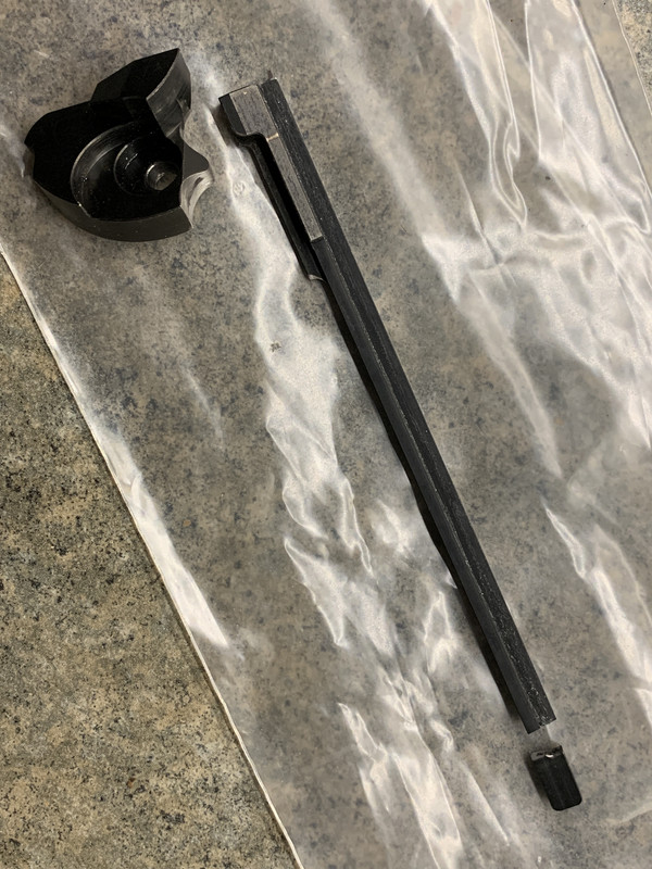

Got the set from DNT today.  The parts are identical and I would be willing to bet they are from the same manufacturer.  That aside, the new set was packed in a faux Pelican case which was a nice touch.
I may have found what caused the breakage in the HGW set.  The carrier was about 1/32” to 1/16” from contacting the trunnion on the left side where it otherwise would be resting.  I removed enough material from the carrier lower rail guide to make it come to a rest on the trunnion like it does minus the parts.  This, while not removing too much to keep the trip from tripping.  I’ll run some more mags through it this weekend to see if that solves the breakage.

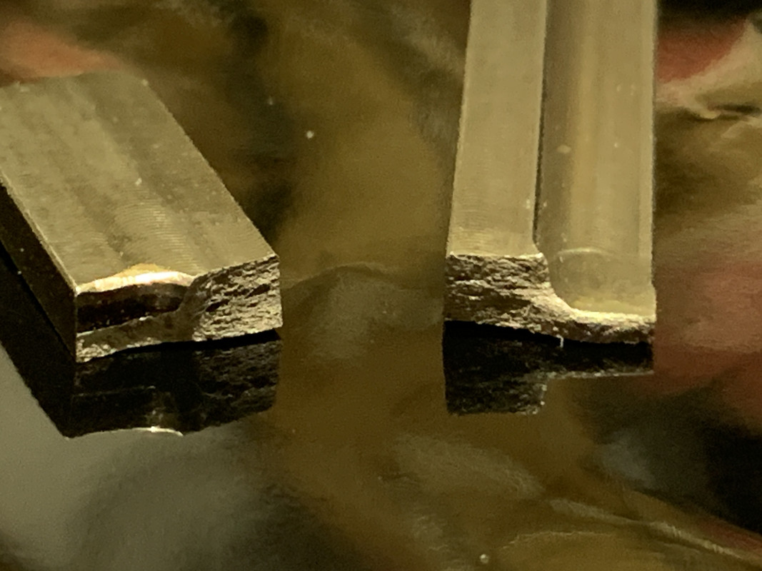

@DFARM can you take a look at the pic Op just posted and tell anything about that grain structure and why it may have failed?
If you don't like the way i'm livin', just leave this long-haired country boy alone.
1/28/2025 10:13:18 PM EDT
https://i.postimg.cc/cJz1V02G/IMG-3158.jpg
The grain looks big. I'm not sure there's enough information in that picture to tell what's going on.
Maybe @kuraki can weigh in a little better than I can.
I'm not sure there's much for us to gain by figuring it out, aside from learning for the sake of learning though. It sounds like the company isn't replacing it and the op has already bought a different trigger.

1/29/2025 12:29:49 AM EDT
[Last Edit: Kuraki][Edited] [#19]
Is this peening?

I’ll get some pics later this week or weekend.  I’m going to try to get the broken part welded back together.  My wire feed will make a mess of it so I don’t want to try.
The part that looks peened is where the carrier contacts it to release the trigger cam.  That was where it was coming to a complete stop instead of on the trunnion.  I fixed that and I should be good to go.
To be continued…
1/29/2025 12:39:39 PM EDT
Yeah I think you've got it worked out.

Got out this morning and ran the DNT frt and it too broke at the same place the other one did with only 20 rounds.  Everything was fine as far as fitting is concerned.  There’s just not enough material there to keep it from breaking.
I got back and put in the new set from Alfa.  In comparison, it was completely drop in with no fitting involved.  I won’t know how it works until I get out again, probably next weekend.

Neither of the two sets I have are a DIAS.  The one that keeps breaking is the one that is pictured first.  It has no interaction with the disconnector.
The Mars set has a piece that replaces the disconnector that is contacted by the hammer to reset the trigger.  I’m going to try this one out this weekend and see if it survives more than two mags worth of ammo.
Any update as to whether the MARS FRT survived?
2/17/2025 11:32:20 PM EDT
The Egyptian bolt carrier was causing some problems this last weekend.  I swapped it out with another and made a new transfer bar out of some spring steel.  I will be back out this weekend to see how it behaves.
I had the broken transfer bar from the HGW set fused back together.  I’m fitting it into the AOW and might try it out tomorrow if I get a few minutes.  If not, it’ll be this weekend as well.
I’ll post if it’s successful.  If there are any questions about fitting these, I can answer them when I’m on.
2/23/2025 10:36:05 PM EDT
After some more trial and error, I got it all sorted out.  The HGW/DNT style has the wrong trigger profile for the cam to interface.  I burned through three triggers getting the profile corrected.  Shortening the trigger is wrong with the cam.  Taking material off the top and working your way forward makes the cam reset the trigger and hold it.  I used the welded trip bar and only did five rounds…one mag with two and another with three.  Functioned perfectly in the AOW!!  The only complaint is the trigger slap being a bit much.
The Maadi carrier wasn’t working due to the contact surface where it interfaces with the trip being fooked up.  I traded it with one from the RPK.  I also made a longer transfer bar to fit it, as the carrier wasn’t resting on the trunnion again when in battery.  Due to time restraints, as with above, I ran a mag of six and another five round dump.  I was able to squeeze off doubles easily and the last five was a dump, just because.  This is the Mars trigger and there’s really no perceived slap.  It’s a simpler and, in my opinion, a superior design.  The $200 price is worth it compared to the other shit where they offer no replacement parts.  DNT doesn’t even respond.
I did find replacements for the HGW/DNT style at https://www.supersafetyshop.com/.  Yeah, it looks sketchy, but I emailed the guy and he responded immediately.  Responded in ‘Murican and was honest with me whether or not he thought his will work.  He did say that the HGW/DNT is a knock off so he wasn’t sure.  Traded a few more emails and decided that I needed a SS for the KS-47 and ordered that shit too, LOL!
Will report back when I get these parts and get a better chance to run what I have a little more thoroughly.  I’ll get some pictures of the correct trigger profile when I tear apart the AOW.  Here’s the Mars kit as received:
