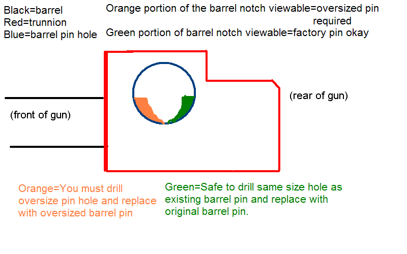

AT that point you look though the barrel pin hole.  Use this picture for reference:
http://www.q45.org/bo/gun/hedspaceing.gif
If the hole is lined up perfectly with the barrel pin notch, then you just put the pin in its place and call it good.
If the barrel is a tad bit forward (you see the green portion of the barrel pin notch showing) then you can just drill it out with the same size bore/drill bit as the barrel pin hole already has.  Since the firing pressure is pushing the barrel forward, you are safe to do that.
However if the barrel is a tad bit rearward (you see the orange portion of the barrel pin notch showing) then you must drill the whole hole oversized so that you seen a smooth concentric hole though the barrel pin hole.  Then you would use the proper sized new barrel pin to put in place of the now undersized factory barrel pin.
