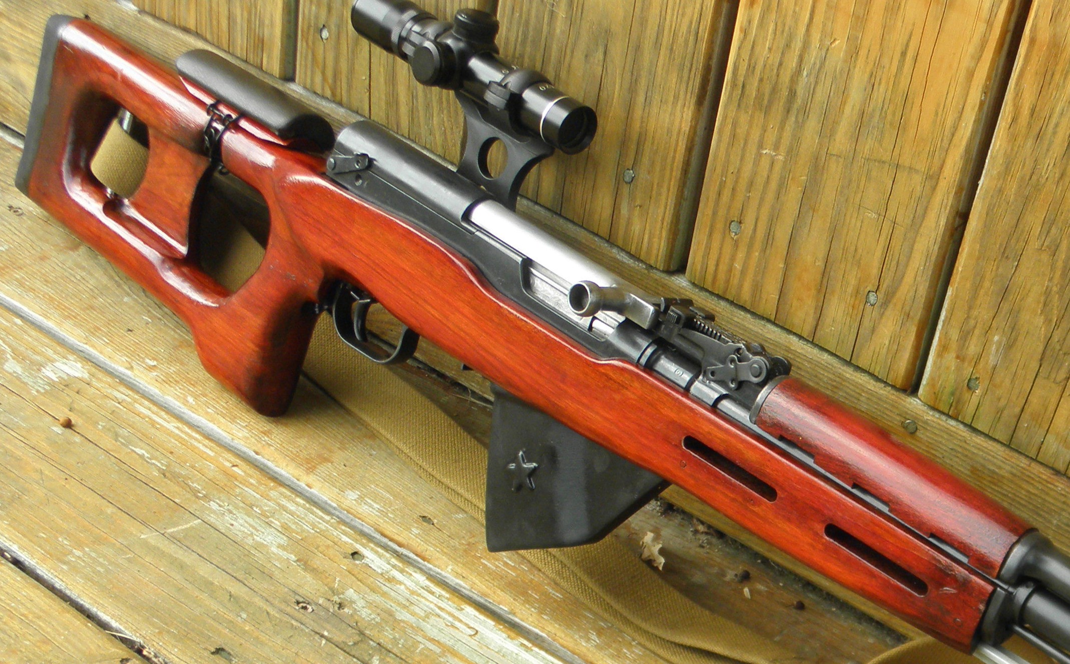

you start with "Amber" shelac , and then mix "Aniline" dye to get the desired hue , you can get aniline dye kits that have multiple colors so you may need to add multiple colors , some you may not think would work , second grade color finger paint class , red + yellow = orange lessons
i went to the dollar store and bought some cheap tupperware tubs , it will be trial and error and you will have some fails so get some tubs , or start saving butter tubs , do not stir vigorously ,because you will introduce bubbles into your mixture and they will carry to your stock when you apply and dry like that , just take your time and gently stiur
buy a couple nice brushes , cheap ones will "pull" out as you apply the shelac and you will be chasing your tail removingbthem and reworking areas and then leaving yet more bristles , so spend $10-$15 per brush and forego the headaches that the $2 ones will cause you
get some test pieces of wood , i used maple , im a cabinet guy so i had plenty , but you can grab a birch pice ay Lowes and cut it into chnks and you have two sides to each chunk to play with
i used dark walnut stain to add depth and contrast to contours , , and the vent holes in my stock , its a Lucky Shot that i had him send unfinished because i was doing alterations and i did not want to have to try and match his finish , or end up having to remove his , it was probably the smartest choice i made all that year and it actually cut his delivery time by 2/3 , it was at my door in one month , a previous finished stock was 3 months , i applied thge walnut stain lightly and then sanded to fade/taper or lighten
