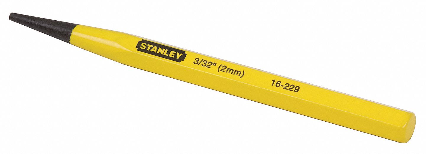

Tricks to getting pins out are to use a "starter pin punch".  This is nothing more than a punch cut off to about a 1/2" working length.
The short length prevents flexing or bending of the punch, which dissipates the force.
Another good tool to start the pins moving is a nail set.

Thanks for the info, and recommendation to use a "starter pin punch". I guess I can cut down one of my cheaper punches for this purpose.

buy a starter punch at sears.  or grind one down from a broken punch.  they taper down to a smaller diameter, no flexing, bending, or breaking.  you can hit them pretty hard.
