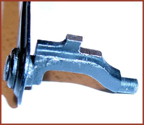

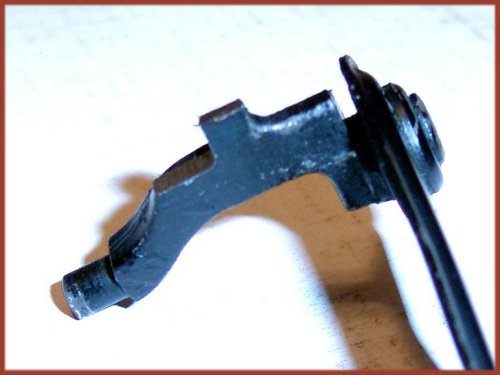

The easiest way is to notch the safety.  Like so.  Let me know how it works out on the range.
Ken RSA
