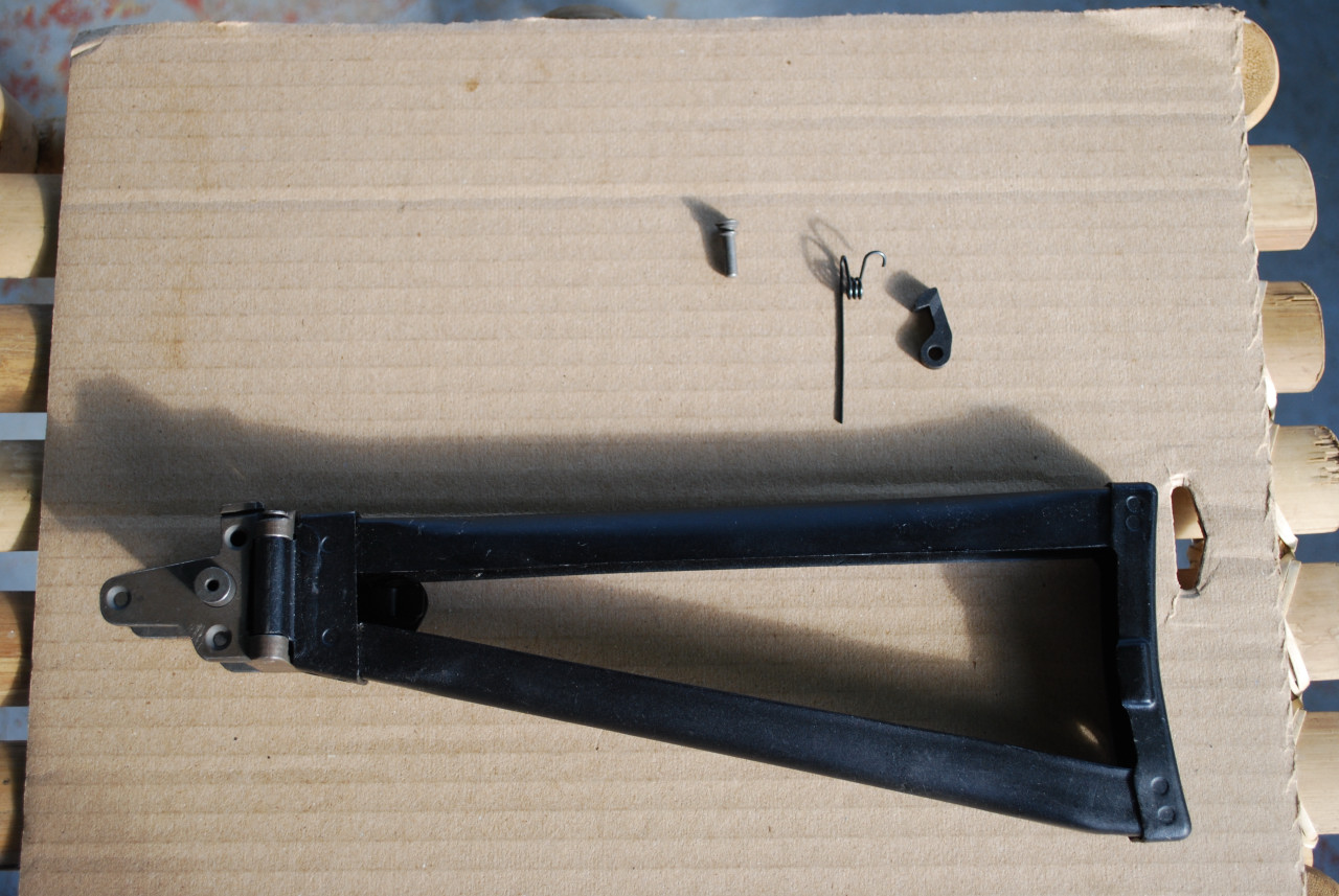

If you're talking about the classic triangle (or polymer) folding stock, then no, it's anything but simple unfortunately.
The triangle folder requires the rear end of receiver to be modified to fit the folding trunnion and the latch kit needs to have a slot cut up front of the receiver as well. It's very precise work and requires rivetting the new trunnion in place. On the SGL20 it also means you have to remove and remount the scope rail. Not impossible to do at home but I'd send it off to a gunsmith long before I tried to do it myself.

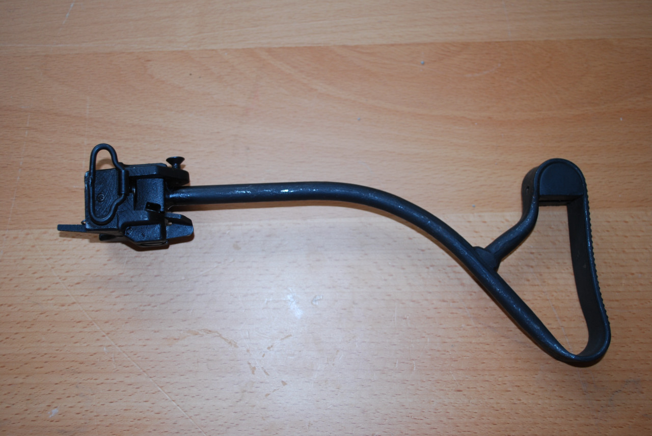

If it's a wire folder then yes, they do fit stamped receivers just fine.

eta: If you're talking about the no mod side folder, then yeah, that is a drop in stock just like the wire folder.
