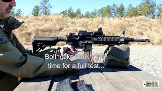

Found this video. It's useless as a test but lets us see the DPM in it's package.
Ultimate AR Buffer System from DPM Systems
