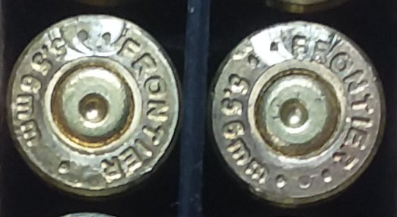

Those were not good results.  His brass showed strong ejector flow.  High pressure or soft brass.  It was more than most M193 I have seen.  You don’t know what you are speaking about saying that’s good.
It's hard to tell if those are ejector marks by the photos and if the ammo is loaded hot that would explain if they were. Doesn't necessarily mean  anything is wrong.
The primers aren't flattened and look normal to me.

No claim to be "expert". Nor do I carry on "speculating" and tossing around half assed theories or assumptions in an effort to validate a half assed decision to buy potentially fucked ammo as some here...
The severe case head extrusion marks in the above pic is a classic sign of over pressure. But they "look good" to you.
Thanks. Everything looks good to me
In Nacho Man's own words.
This was shot out of a 11.5 DTI upper with a H2.
Very accurate but they are on the warm side.
No abnormal wear is noted on the internals.
I do have some of the casings from the AE223 and
they had a good amount of ejector swipe too
so I wouldn't just attribute this to the Frontier ammo alone.
The Frontier casings did eject farther though.
Again, i state that it looks good to me.
It's ammo loaded on the hotter side.

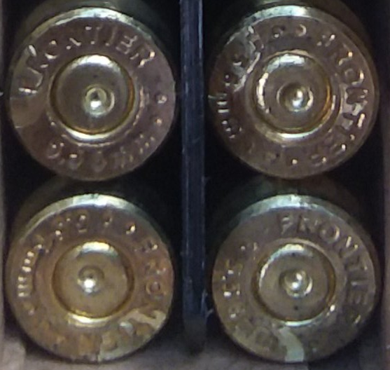

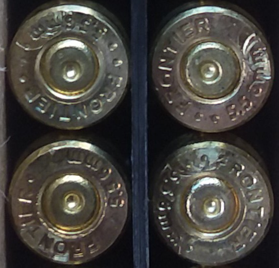

Shot it today. The ones marked with the x are the two I disassembled and reassembled; seating the bullet  to 2.240.
I was checking the brass every few shots . I shot 20 rounds but foolishly lost one piece of brass because I forgot to put my brass catcher back on.

Those were not good results.  His brass showed strong ejector flow.  High pressure or soft brass.  It was more than most M193 I have seen.  You don't know what you are speaking about saying that's good.
https://i.postimg.cc/P5rcTwYG/screenshot-65.png
https://i.postimg.cc/7Z2zCBgS/screenshot-66.png
https://i.postimg.cc/QCzBC5C6/screenshot-67.png
Can one of you guys school me on what I'm looking at here? Is the issue the markings around the edge of the case, or something to do with the primer? Or something else completely..
8/24/2019 5:20:02 PM EDT

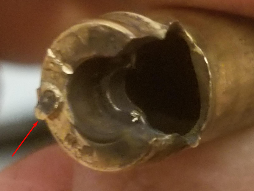

Ejector flow is when high chamber pressure causes the brass to move, swaging the case head and flowing into the the ejector.  The ejector in the bolt is spring loaded, and will back out and allow brass to flow into this area.  This is a really good inidication of high pressure.  Flattened primers are not always good determinator of pressure signs, they are just one of multiple indicators.  However, ejector flow is always a good determinator of high chamber pressure.
Here is a Frontier case from another kaboom, in almost all failed cases, the case fails at the case head, where the extractor does not fully support the case.  This blows out the case head on this side, and allows the pressure to enter the bolt.  However, notice the area marked in red?  This is ejector flow.  You will almost always (if not always) see this be pretty extreme on a kaboom.
It is normal to see SOME ejector flow on SOME M193, in SOME guns.  This is because M193 is above SAAMI spec for the 223 cartridge, and the higher chamber pressure will show this as a side effect.  When ejector flow is high, you will also see the "swiping" which if the ejector flow area of the case get getting cut/shiny caused by bolt rotation while the brass is still obturated against the chamber.  When you see a lot of swiping marks, with ejector flow, thats a sure sign of ONE of two things:  high chamber pressure, or brass with incorrect hardness (too soft).  It is almost always pressure, however.
More ejector flow:
A popped primer is also a sign of pressure, especially with significant ejector flow.
In the above picture, you see popped primer, ejector flow, AND damage opposite the ejector from flow into the extractor void, or from hard extraction.

8/24/2019 6:00:38 PM EDT
https://i.postimg.cc/0jPW9PfQ/screenshot-68.png
More ejector flow:
https://i.postimg.cc/g2cRX4HD/screenshot-513.jpg
https://i.postimg.cc/Dywy1NR8/screenshot-517.jpg
More ejector flow:
Thank you very much for the detailed explanation and examples. Everything you explained makes sense now, and I had no idea what any of that meant until 5 minutes ago.
I'll start watching my brass a little more closely now. I don't have any Frontier, but I do have a bunch of couple-year-old IMI stuff that I kinda remember people mentioning as possibly 'hot'. Good education for me, thanks again.
