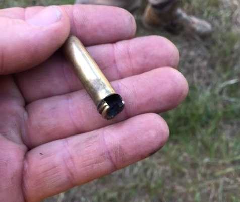

Okay, I came across this thread and felt compelled to give my testimony. As you can see I have been a member a long time but mostly read and don't rant.
I bought 12 boxes of Hornady Frontier 5.56 55gr. last June at Shoot Straight Pinellas (great shop, not their fault) the weekend before my brother came in town. I was excited about shooting with my bro, so I loaded my mags up that weekend, I didn't want to waste any range time loading mags. So I loaded it into some brand new pmags and threw away the boxes and receipt, smart right?
So the next weekend my brother and I go to the range. On the first mag I get a jam about ten rounds in, no big deal right?
I clear it and keep shooting. every few rounds... jam. Jam, jam, freakin jam. Five mags like this. I pop in some Winchester USA stuff I had left over in my bag, all 30 fire with no problem.
Put a fresh unused mag of Hornady Frontier in and jam. Okay so at this point we are both like what the hell? Hornady makes the best, whats going on?
The range master comes over (he probably got red flagged by seeing us clearing a lot of jams) and he asks my brother to see the weapon. It had just jammed again and my bro pulled the mag out to clear the action so he could hand it over and as soon as the mag came out BAM! Slam fired!
My brother was a bit pissed and embarrassed, to say the least. I checked out some of the casings lying around and many were smeared on the head with odd swelling damage. We decided we were done with shooting the M4 that day after that. Before I put it away I noticed the trigger felt weird. When I got home I stripped it and looked to see what could have made it slam fire, and why my trigger felt strange. Wedged up under the trigger was a flatted primer! The hammer would not lock into place because of this.
When my brother pulled out the mag the bolt dropped due to the stoppage being what was keeping it back, okay, that happens, but slam fire? Hell no! When the bolt closed the hammer was hot on its heels! This ammo, is not only crappy and unreliable, but downright dangerous.
It does not appear to have done any damage to the weapon.
I now have the rest of this sitting here, I can't return it.
The weapon used is and M4A1 with CMMG upper, barrel and bolt. I have owned it for 14 years and never had so much as a hiccup from it, no matter what ammo. It has M4 feed ramps and 5.56 chamber. My brother and I have been shooting AR15s and M16s for 35 and 43 years respectively.
Anyway I posted this because I don't want you to get hurt or damage your property. I still buy Hornady pistol ammo, but never this line again.

Sorry to hear about your bad experience.
Have you tried contacting Hornady? I would. What do you have to loose?
Also, do you have the means to pull the bullets and weigh the powder? You might not get any useful information doing that; unless you discover like over 28 grains of powder.
Blown (especially crimped) primers is serious overpressure..Not good at all.

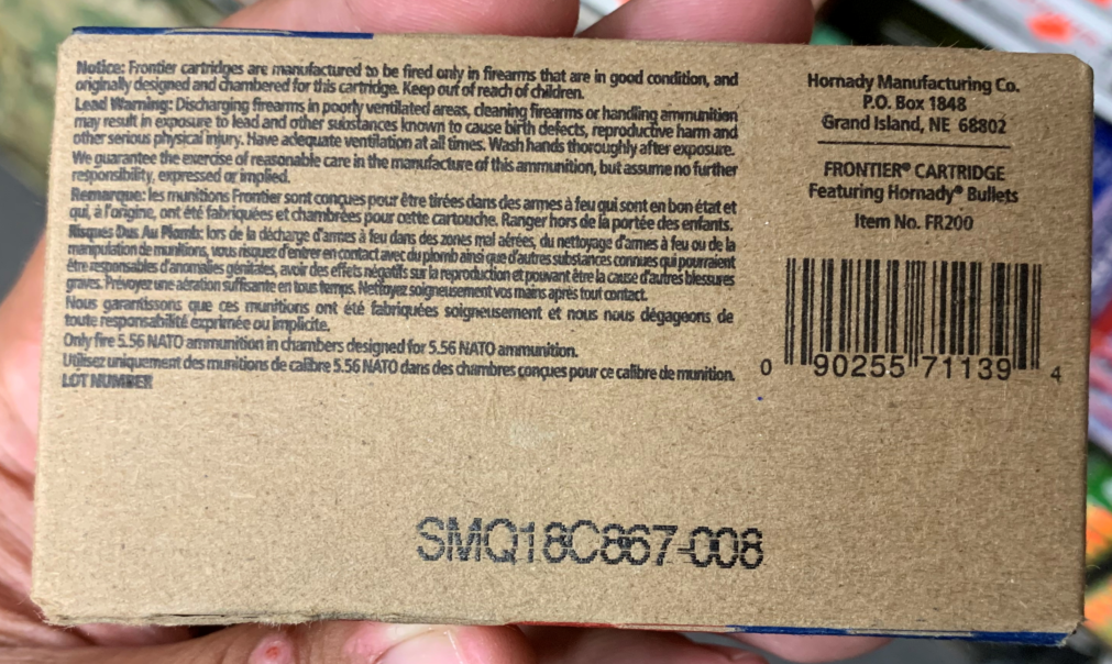

New kaboom:
https://www.ar15.com/forums/ar-15/Another-KA-BOOM-with-Frontier-5-56-ammo/16-744066/
https://www.ar15.com/forums/Armory/Damaged-YHM-Turbo/17-503258/
There have been many kabooms where the lot number was unknown or unreported.... but of the reported lots (so far)
SMQ18C844-002
SMQ18C844-003
SMQ18C847-001
SMQ18C867-008
