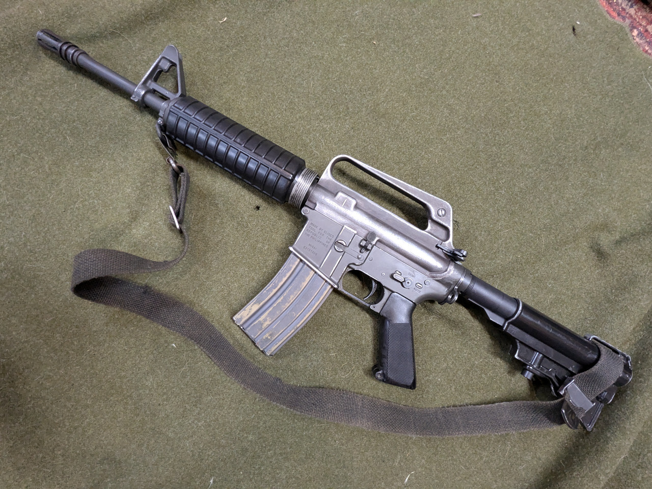

 Do something retro interesting. My Elisco build nails it as a utility pistol! It was also a cheap build and super lightweight.

Nice rifle!
I have one that's "retro" already.  I call it my "Base Rifle."  Basically looks just like yours and is plain jane as it could be, but it never fails.
I am looking to do something more "modern."

3/23/2026 4:23:39 PM EDT
https://i.postimg.cc/5yLHkxnZ/PXL-20260215-221548223.jpg
Hell yes!  It is still my favorite shooter, with a Mini 4 mounted, it is still pretty light.
