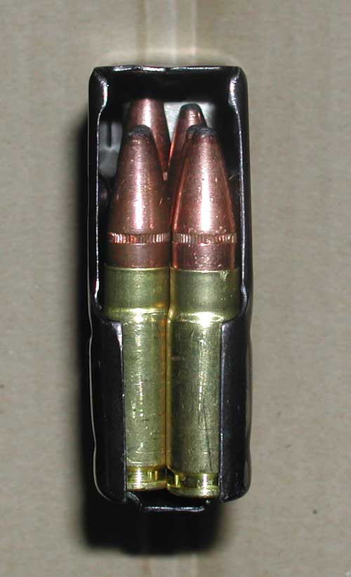

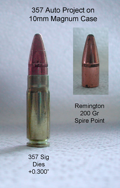

Your 338 Spectre inspired me to try something similar with 35 caliber on the 10mm mag case.
Necking it down with 357 sig dies held 0.3" long.
I thought you mentioned trying it, but I don't remember the results.
Please tell me if I am walking myself into a design problem prone idea...
I'm not so interested in the subsonic use as the supersonic uses.
I have a few guys interested in the cartridge and one guy emails me a link to another guy that did the same thing almost 2 years ago in an encore.
Turns out the guy lives 20 miles from me and has wanted to try it in an AR for 2 years now.
Thank goodness for PRI 6.8 magazines...
www.ar15barrels.com/gfx/357-auto.gif
www.ar15barrels.com/gfx/357-auto.jpg
www.ar15barrels.com/gfx/357-auto-mag.jpg
www.ar15barrels.com/data/357-auto-feeding.wmv
Randall

Funny how things go ... the 35/40 Auto was my inspiration for the 338 Spectre.  Guess Ben has been the source for all of our inspiration
