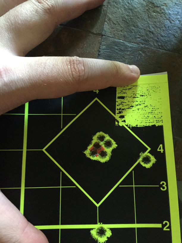

Ok will do. Going to the range this Saturday and will shoot 4 groups @ 100 with my 300 BLK. To be honest the group on the bottom right looks pretty indicative of what my gun produces.

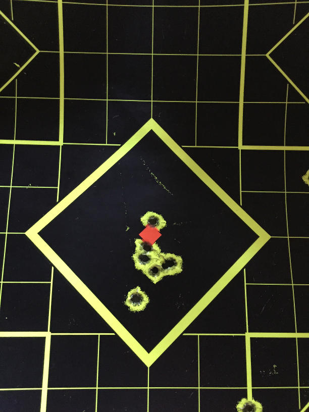

My load testing has all been at 50m. Upper is an AAC factory 16" and optic used was the SWFA 1-6. With 125gr SMK, 125gr Nosler ballistic tip, 110gr AMAX, and 150gr FMJ, all over Lil'Gun, I would get one ragged hole with at least one of the loads for each bullet. Hopefully I can get to the range this weekend to test them at 100m, but I am fairly optimistic they will hold 1 MOA.
These were all five shot groups. I am by no means an accomplished shooter so I was pleasantly surprised by the results. |

5@100 out of Daniel Defense CHF 16" S2W contour </a>CAM00234 by Adam C, on Flickr" />
10 rounds 14.0 gr AA#9 150 gr Hornady spire point @ 50 yards out of 8" Aero Precison barrel and mepro tru dot rds |
