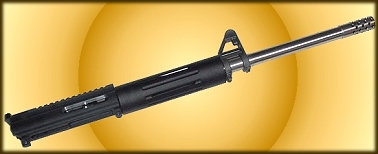

I am not familiar with the shrewd brake, can someone post a picture
Thanks
Chris
5/12/2005 12:55:24 PM EDT
Shrewd brake:
http://www.teppojutsu.com/images/BaseA2Shrewd2.jpg
5/12/2005 7:44:50 PM EDT
Up close picture of the Shrewd brake on a .458 SOCOM.  This one was installed on a bead blasted SS Lothar Walther barrel and given some "artistic enhancement"
As DoubleARon and BigBore stated, the brakes are not overly effective due to the low muzzle pressure and large bore.  We did indeed install the JP Recoil Eliminator on one for a customer and even that customer commented that it was not worth the trouble ... that JP now gathers dust in the corner of the shop, as I have no big bore that needs it.... it is opened up to .458 ....
