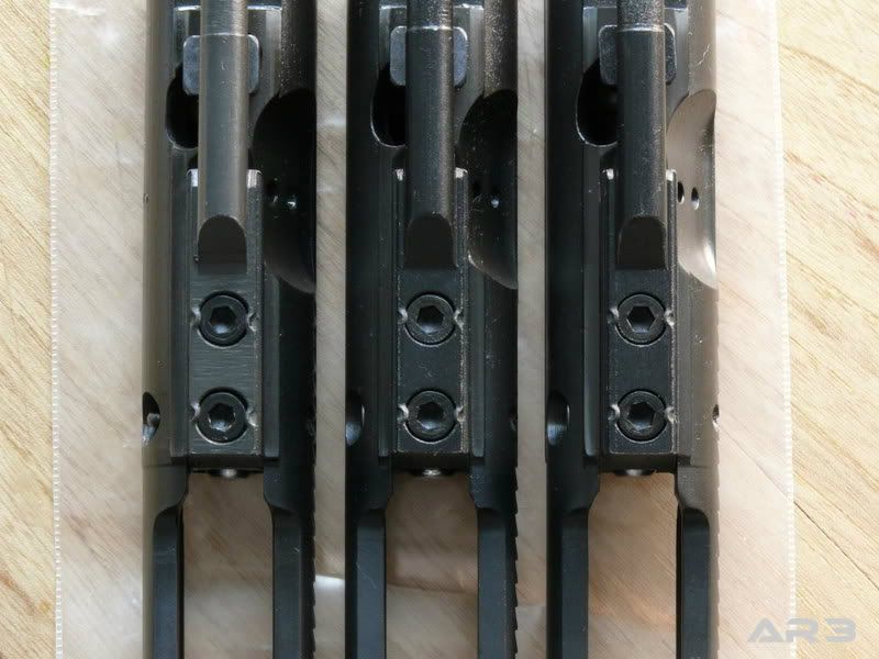

My Colt BCG on the left and the rest are LMT, examples of factory properly staked gas keys
For myself I prefer these features on my BCG:
HPT bolt (High Pressure Testing)
MPI bolt (Magnetic Particle Inspection)
M16 full auto carrier
Properly side staked gas key
