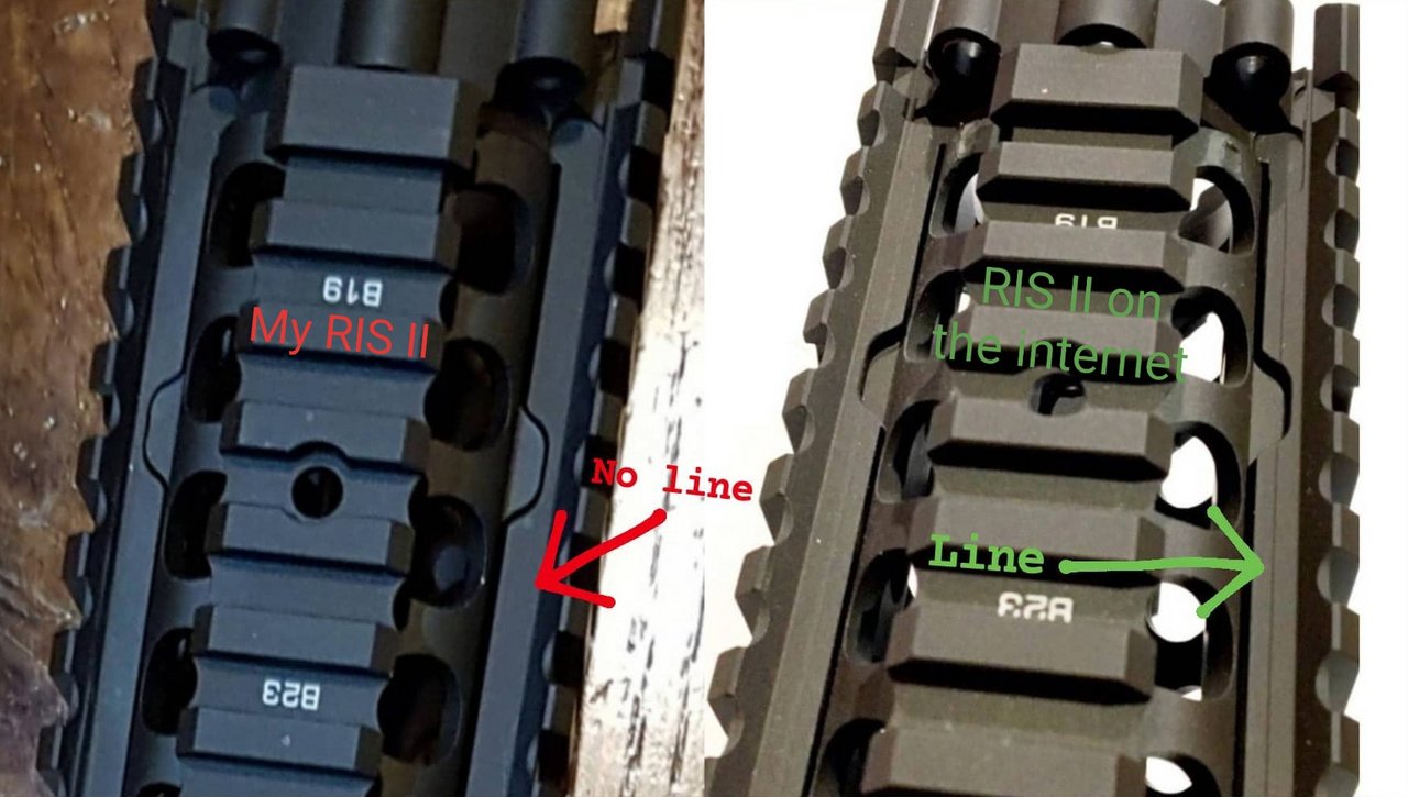

Hi guys, I've recently purchased a black DD RIS II 12.25"  from Charlie's Custom Clones. I was trying to make sure it's an authentic one, and I find out a detail that worries me a little. On the bottom of the original RIS II, there is supposed to be a line that mine does not have.

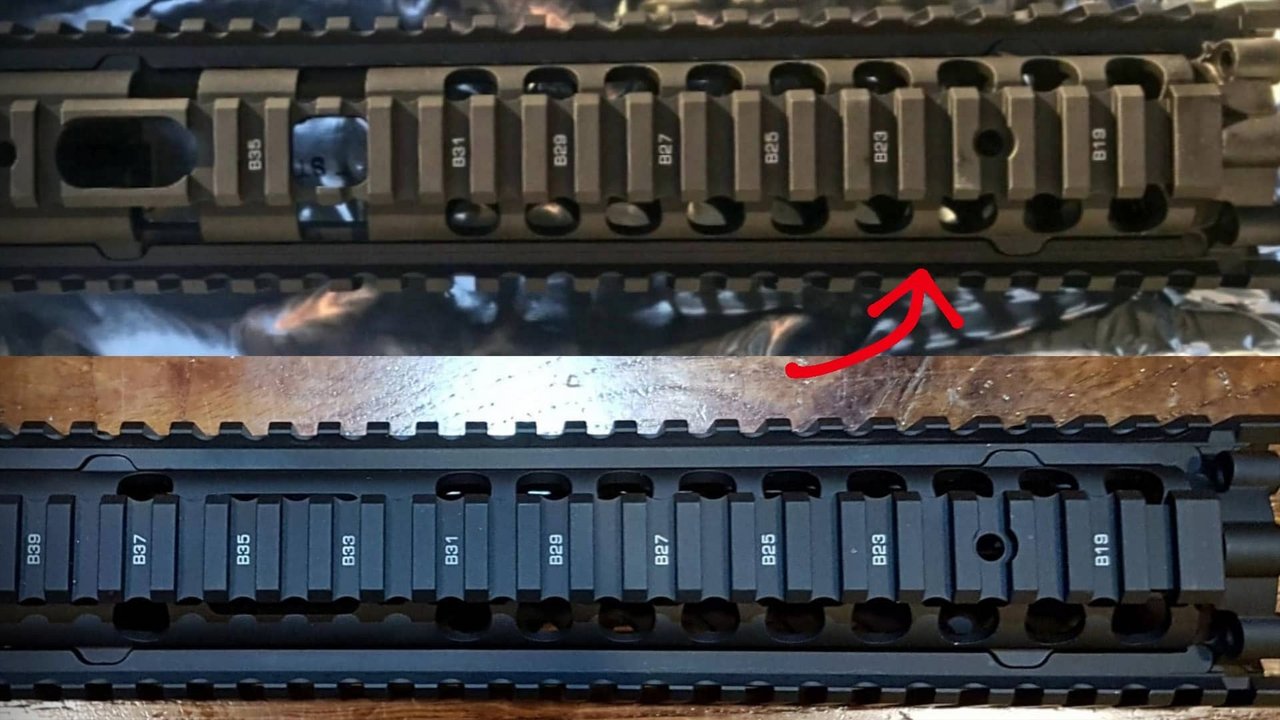

Here's a picture of my RIS II compared to a picture I've found online. Can anyone tell me if mine is ok, or if it's a fake ??  Thanks
1/30/2021 2:48:04 PM EDT
I have the short  DD FDE RIS II still in the plastic and I don't see that line in it through the clear plastic.
It doesn't have it.

What you're seeing in the online photo is just a minor machining imperfection; not remotely something seen on all RIS IIs. None of mine have it.
Unless there is some other indication of a fake product, that alone means nothing.

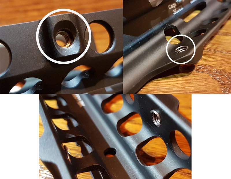

Thanks for your answer! Does your RIS IIs has this type of thread inside the bottom part of the rail ??

The problem is the FDE rail is for a FSB while the other is for the low profile gas block. So it's hard to say they would have the same appearance/design.
The black one won't have the same markings as the FDE because the military does not buy them. I have a black Mk18 rail and it does not have the NSN number on it like the FDE one does.
However, based on your pictures the black one may be an airsoft clone. It is difficult to tell but it does appear to be a replica. I'd have to see more pictures of the markings and bolt up kit that you got with it. Also it should "feel" wrong. There's no way they can replicate the metal and the feel of it. Do they both feel like the real thing?
https://i.postimg.cc/RZ6HdWQ4/Picture.jpg
Take this for what it’s worth.  I saw a post where it said legit DD rail, the threaded inserts will be a pinkish/purple color, yours appear to be silver.
Best bet at this point is to contact DD.

Looks like the EMG DD RIS II airsoft rail, but I can't be sure without it in my hands. I would hope someone didn't buy a bunch of near clone airsoft rails for $80 and then turn around and sell them as the real thing for $$$.

M4A1 RISIIs have changed slightly over the years. I have 3 of them (black) and two are older models that are slightly different than my newer one. All 3 of mine have the line you're asking about though. I wouldn't say for sure that the missing line means it's fake though, it may just be a version I don't have? Does your rail have Helicoil inserts where the bottom rail screws into the top rail? All of mine have Helicoils with a red tint to them. I doubt a fake rail would have Helicoils? If it's missing the Helicoils, it's probably fake.
Edit= I just noticed your rail does have Helicoils. I'd guess it's real unless someone put a lot of effort into making a fake rail exactly like the original? Your Helicoils don't have a red tint like mine but maybe the color has worn off, or maybe DD used different coils at some point?

Thank you for sharing so many pictures.
Upon looking at it, your rail appears authentic to me.
A few things I notice that are present in all DD rails, but don't seem to be on fake ones:
1) Two notches on the top rail near the front. Every DD rail seems to have these two notches in the front as if it was clamped on some tool at the factory. Some people mistaken it for a defect.
2) The top rail section, where the top two set screw goes in generally have the threads going past the rail a little.
3) The set screws have the chalk-like locking thread compounds on them which you generally won't see on fake ones because the compound cost quite a lot of money and comes in jugs. I've seen people use the ceramic tan paint that you can buy at an arts and craft store to pass it off as real.
4) The barrel nut appears to be of the old design. I have one from about 7 years ago that has a similar barrel nut. The newer barrel nut seems a bit smaller than that and not black.
Overall I'm about 85% positive this is real. The concerning items are the bottom rail piece and the way it fits into the bottom. However, according to CCC this is a "rare" black version of the rail. I don't think I ever seen a black full length rail in a while so they may have constructed it differently.
