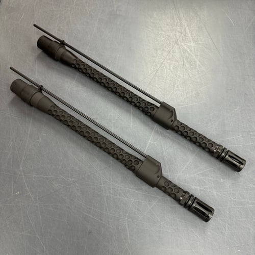

Is Marvin the only legit source of these still?
I want to get my pig of a LaRue some dimples.
3/14/2025 9:40:01 PM EDT
I had a Proof done by Templar Precision and the work was top notch.  I think D. Wilson offers it as a service, too.Attached File

What I read is the Knight's style dimples is a licensed thing. So you can get different dimples, but if you want KAC dimples...
I don't think Nefarious Arms/Marvin Pitts does personal orders like that anymore.
Oh dang, I spoke too soon. See post above, that looks great
