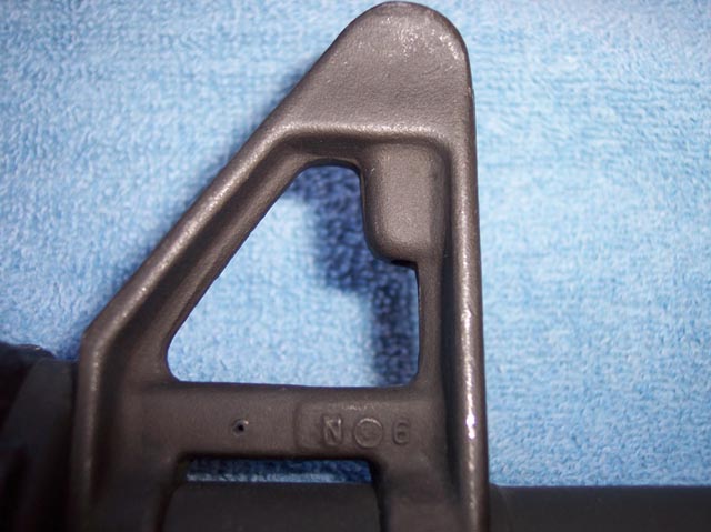

Early complete gray FN upper:
6/2/2012 2:28:57 PM EDT
I have an FN upper half marked exactly the same, but in jet black, and an FN upper half with a  F and split A (Anchor Harvey), also Jet black. Anybody seen a grey LK marked upper half with a C MP barrel, if I remember correct these were FN contract replacement receivers.
