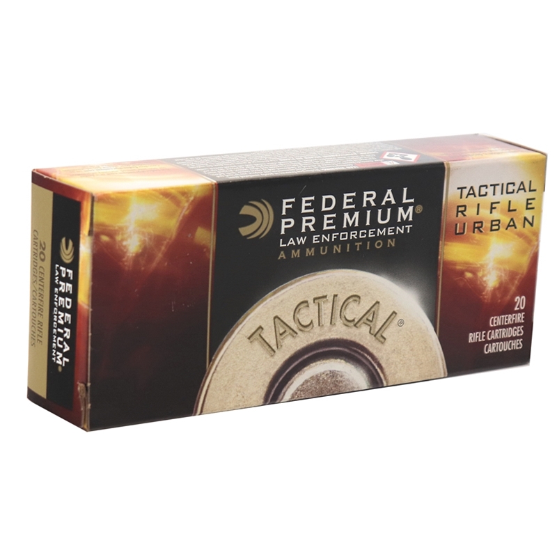

Posted: 11/20/2016 6:39:44 PM EDT
I recently got a hold of some Federal TRU loaded with 55 grain Nosler ballistic tips as seen here: http://www.targetsportsusa.com/federal-le-tru-223-remington-55-grain-nosler-ballistic-tip-t223f-p-1309.aspx
I decided to see what kind of accuracy I could get with it out of my SPR type build. It has a WOA 1-7 spr profile barrel. I shot three 10 round groups at 100 yards. Temp: 59 degrees Humidity: 72% Barometric Pressure: 29.90 in Elevation: 825 ft I shot these groups prone off of loaded bipods with a sand sock/squeeze bag filled with wheat berries. Yes it was raining! I intended to shoot all three groups on one sheet of paper, but the POI was a bit off, low left, so I shot bottom center, bottom right, top center, in that order. Group 1: 1.521 MOA Group 2: 1.558 MOA Group 3: 1.842 MOA
The 3 group average was 1.64 MOA |
Great shooting. Those nosler ballistic tips are a performer it seems. I wonder what kind of velocity they are kicking around at. I would say any flesh round that is capable of ATC's averaging around a half moa is worth keeping around. Next weekend I will try and get out to shoot a few 10 shot groups of my gold dot 55s to compare. What magnification scope were you using and what length WOA barrel?
It would be awesome if more people put up honest ammo reviews like this. |
Great shooting. Those nosler ballistic tips are a performer it seems. I wonder what kind of velocity they are kicking around at. I would say any flesh round that is capable of ATC's averaging around a half moa is worth keeping around. Next weekend I will try and get out to shoot a few 10 shot groups of my gold dot 55s to compare. What magnification scope were you using and what length WOA barrel? It would be awesome if more people put up honest ammo reviews like this. Thanks bro. I don't have access to a chrono right now, but the box lists a 3220 fps muzzle velocity. WOA 1-7 18", with rifle length gas port, and vortex flash suppressor, matched WOA bolt, and the barrel is bedded in a mil spec M4 forged flattop upper. The scope used was a Leupold mk4 4.5-14x in a Larue SPR-E mount. Shot on 14x. |
