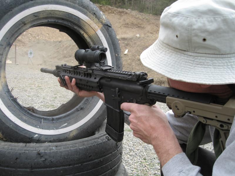

3/22/2007 12:04:19 PM EDT
We didn't care for the SIR, but the M468 upper RAN GREAT
 [ link to LARGER image ]
