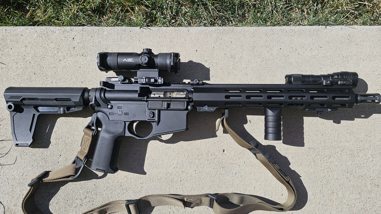

I have that barrel, it’s proving to be damn accurate: Attached File |
