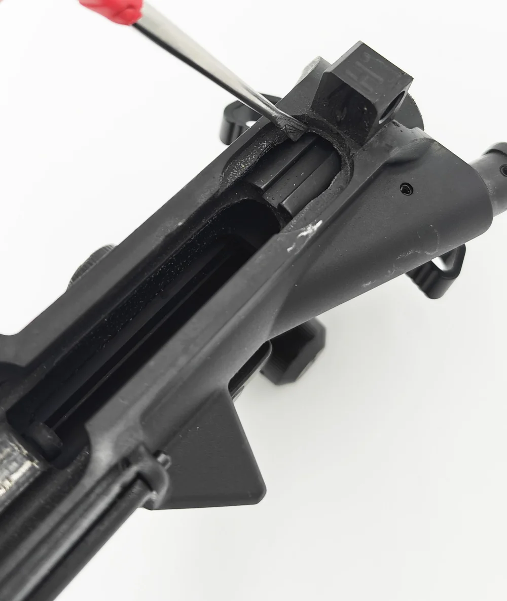

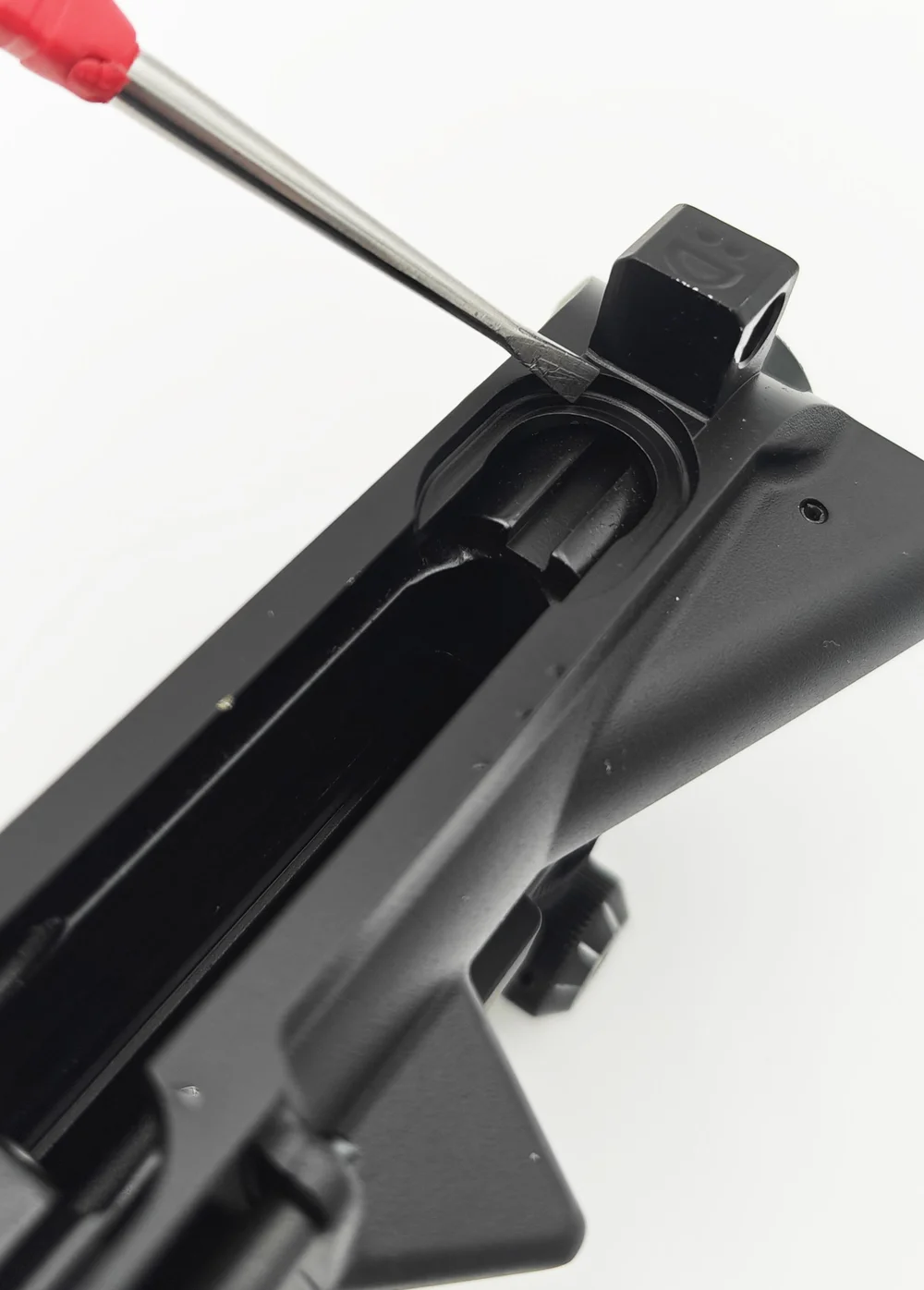

Per the AS Designs Troubleshooting Guide:
https://activesafetydesigns.com/troubleshooting/
Issue: The charging handle or bolt carrier group “binds” or “sticks” about ¾ of the way to the rear.
   Solution 1: The rear shelf of the upper needs to be cut to prevent the lever from being pinched between it and the BCG (Bolt Carrier Group). Please see Pictures 2 and 3 below for before and after examples of the shelf cut. You may use a Dremel to quickly remove this.
   Solution 2: This solution should not be needed if the aforementioned upper cut is performed, we do not recommend this solution in 99% of installations. The flat “top” of the lever is too tall and needs to be ground down some to prevent binding between the BCG and cam. If it is still necessary, use a Dremel with a drum sander (40-80 grit) to grind the top of the lever some until it functions smoothly. Note: We will not cover any failures of the lever resulting from this modification.
   Solution 3: If the bolt is over-traveling too far into the buffer tube, you either need a longer buffer (rifle length buffer) or you may place 1-4 quarters in the rear of the buffer tube behind the spring to “shorten” the tube (not our recommended solution, but it has worked).
I recommend you read the other trouble shooting tips.
Also make sure you are using a low shelf lower receiver.
