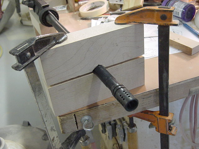

Originally Posted By TGWLDR:
https://i.postimg.cc/Njp1QkrM/etgk-I0j.jpg
Bingo.

Get some clamps
