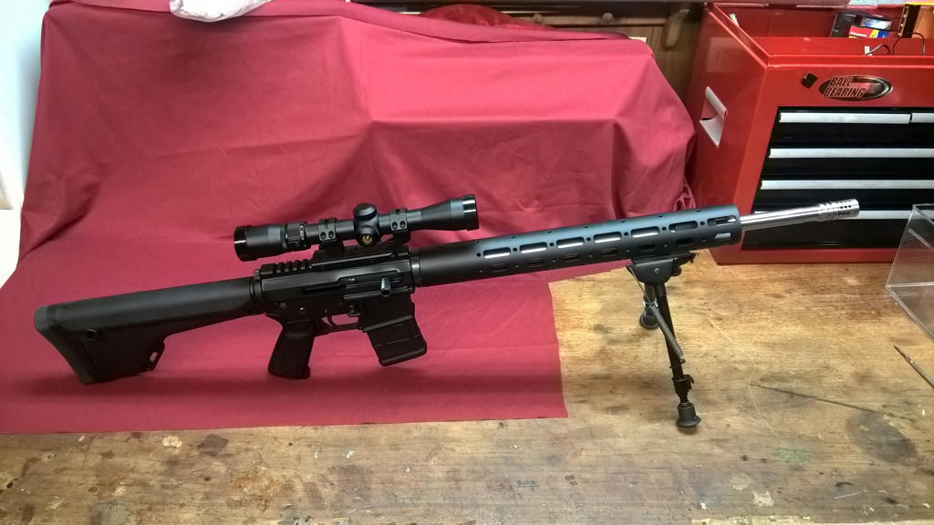

Rifle in question. Had a page on what exactly went into it, but the character limit made short work of that, so feel free to ask. Took it out to the range and fired ~200 rounds through it so far, been busy lately so I haven't had much time. Functions flawlessly, which surprised me being that I've never even owned an AR before let alone ordered one in piece-by-piece. Accuracy-wise, though, it doesn't shoot for crap right now (as expected, to be honest)... probably a 4" group at 100 yards with Federal factory loads. Haven't gotten around to getting reloading supplies yet because I still haven't really settled on a caliber. Barrel is one of MidwayUSA's AR-Stoner branded .223 20" Stainless HBAR barrels... it certainly looks nice, but I wasn't banking on $100 of barrel being too accurate. The BCG is whatever came with the same AR-Stoner side-charge receiver; the receiver itself is exactly what I was looking for (I think it's a Bear Creek rebrand?) and is milled beautifully, but the BCG leaves a bit to be desired and so I've been watching for something to replace it with. Eisenach and Young Mfg both appear to have units which will work dimensionally with the upper. I'm just gonna fire off questions here: Any thoughts on how long it takes for a new barrel to settle into how it's going to be shooting reliably? Any recommendations for a reasonably priced 6.8 SPC barrel and/or quality barrel mfg's in general? What should be the first steps in getting group sizes down in terms of work on the rifle itself? Looking forward to it! Much appreciated, - M |
4" seems like a lot at 100 yards with a stainless 20" barrel. I would make sure that everything looks right in terms of not over or under torquing the barrel. I would also make sure that you have the rifle shooting fundamentals down in terms of breathing, trigger pull, etc. Does it have a stock trigger? Are you using a scope or irons?
Edit: If that was my barrel with a free floated hand guard and a decent trigger, I would at least expect 2-3 with factory cheap ammo. I would expect 1 or under with a good trigger/glass and good marksman fundamentals down. |
Nikon ProStaff 2-7x32 (inexpensive but still pretty nice), and a stock trigger group from an Anderson lower parts kit. Lapped the surfaces on a sheet of glass (If you're ever about to sh*tcan a printer/scanner, scrap the glass out of it. It works great for things like this. I'll go dig out the best target it shot last range trip and stick it up here. Might have been closer to 3-3.5", but definitely nothing I'd go around showing people and going 'look at this'. I'm going to go throw some more lead downrange tomorrow and see if it does any better... I know I was literally cleaning the machining scrap out of this barrel when it came to me in a tube, it must have been rifled and sent right out the door. |

Where did you learn how to assemble the rifle? What tools did you use? Have you tried other ammo? Improper assembly, out of spec parts, loose barrel nuts & rails or scope mounts can all cause accuracy issues. Also, most non-match ammo is 2-3 moa but don't perform the same in all rifles. Stainless barrels should settle in within 100 rds and many people don't believe there is any break-in period in a barrel. As for 6.8 info, there's a whole 6.8 SPC forum you know. ARPerformance and Black hole weaponry (I think) are 2 of the better 6.8 barrel makers. Posted Via AR15.Com Mobile |

BCG What exactly is your issue with the BCG? I'm sure you know that the parts of a rifle function together to perform the job. You can have a $2000 rifle and a $2 spring could throw off its performance. You could pour money on this project searching for an answer, money better saved to buy more guns. If you don't mind, throw up your parts list, tell us how you put it together and where you learned to do that. There is a big difference in doing it and doing it right. There is a lot of combined knowledge here. I think Krusty was trying to get this across but was a bit grouchy in his approach. |

Northern Wing. Welcome to the forum and interesting looking rifle right there. You have a lot of questions and a lot of reading to do it seems. Looks like you jumped the gun on some of your parts and are already thinking you want to replace them. People around here have a term thrown around buy once cry once. Some people misinterpret it to mean... ... Enjoy your new rifle. Thanks! I did run this pretty cheap since it was my first build and I'm fully prepared to scrap a few things now that I have a better idea of what I'm doing, the barrel unfortunately being one of them. It was a good learning experience. I'll have to check out the classifieds around here to see what all's for sale. I don't mind the rough welcome from a few people... I'm a computer hardware (read electrical) engineer by trade and so I've certainly made my rounds around the internet. Maybe I could have grabbed a better barrel out of the gates, but I figured I'd rather learn on something cheap and wait a bit to buy something really nice than grab something more middle-of-the-road and feel bad about ditching it later anyway. Just my thought process. 2000-character limit is killing me, by the way. |

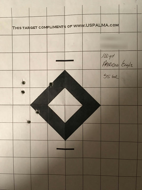

Here is today's best target - it's trying to group American Eagle a bit to the left apparently, but it does appear to be bringing them in a bit. I'd post the older targets if I still had them... It's quite the improvement though. For now, I'll keep shooting her and see how things go - like I said, I completely understand that there are some cheap parts on this rifle, but if something stands out as being underwhelming, it's probably because I plan on replacing it in the future once I have a better understanding of what I'm doing anyway. I really just wanted to say hello to everyone around here and listen to some opinions on what to tackle first. Glad to see all the interest!
