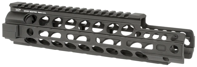

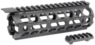

MI Gen2 Two Piece Drop-In Picatinny Handguard
From MI's website
MI AR-15/M16 Two Piece Drop-In Handguard, M-LOK
From MI's website
MI's Two Piece Free Float Handguard is listed below under free float picatinny handguards

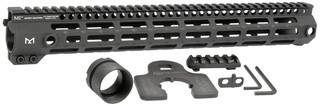

G4 One Piece Free Float Handguard, M-LOK
From MI's website

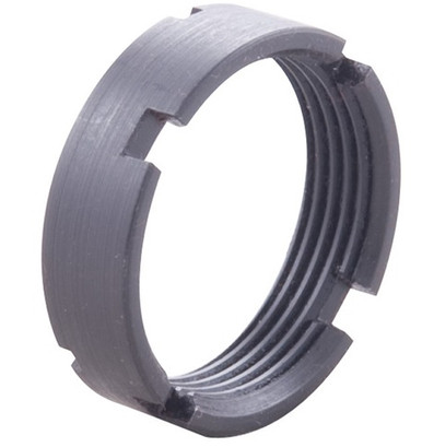

Castle Nut
BCM, Griffin, ADM, and MI all sell castle nuts.
ADM's the only substantially different of the castle nuts, with a lightweight aluminum offering.
ADM Light Weight Castle Nut
From ADM website
The rest appear to be phosphate finished mil-spec.

Midwest Industries
From MI website
Look carefully at the BCM and Griffin castle nut pictures.  On the threads, to the left of the upper right notch you can distinctly see 4 bright spots in a pattern on the the top thread and a single bright spot on the next thread down, right next to the notch.  The wear patterns on the close edge by the front right and left notches are the same, too.  Not only are BCM and Griffin likely sourcing their castle nuts from the same place, they are using the same picture of the same castle nut, just with different editing.

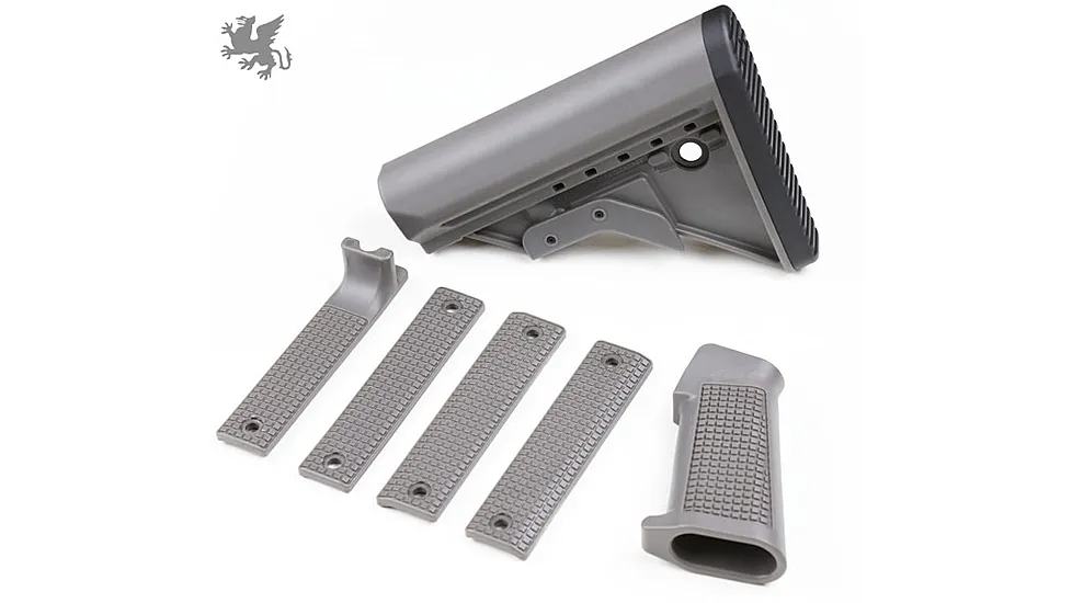

Griffin - Extreme Condition Stock
I've only seen this as part of a furniture set with an A3 grip and M-LOK rail panels.
Griffin Armament AR Furniture kit: Griffin Extreme Condition Stock (ECS), Rail Shield M-LOK set, and A3 Grip
From OpticsPlanet.com website
I went with the BCM Stock Mod 3.  With a QD socket on the receiver end plate, there's no need for one here.  A slot for a sling to loop through is adequate.
