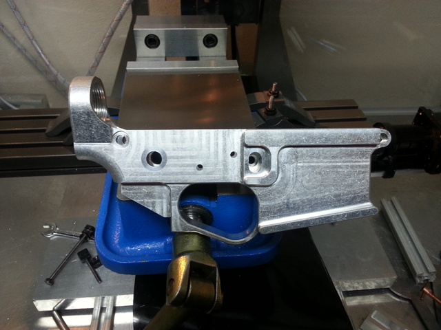

Another well made , made in the USA mini-mill, Check the Taig.
Here is mine.... CNC equipped.. But when First I purchased it, I had the manual handcranks installed.
They put the Stepper mount in a bag......
