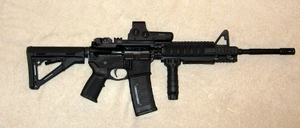

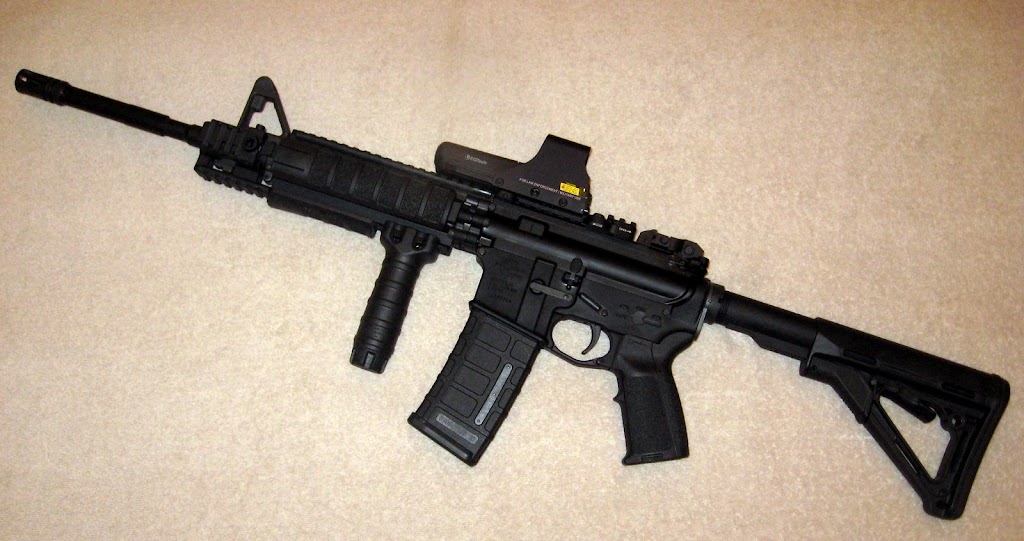

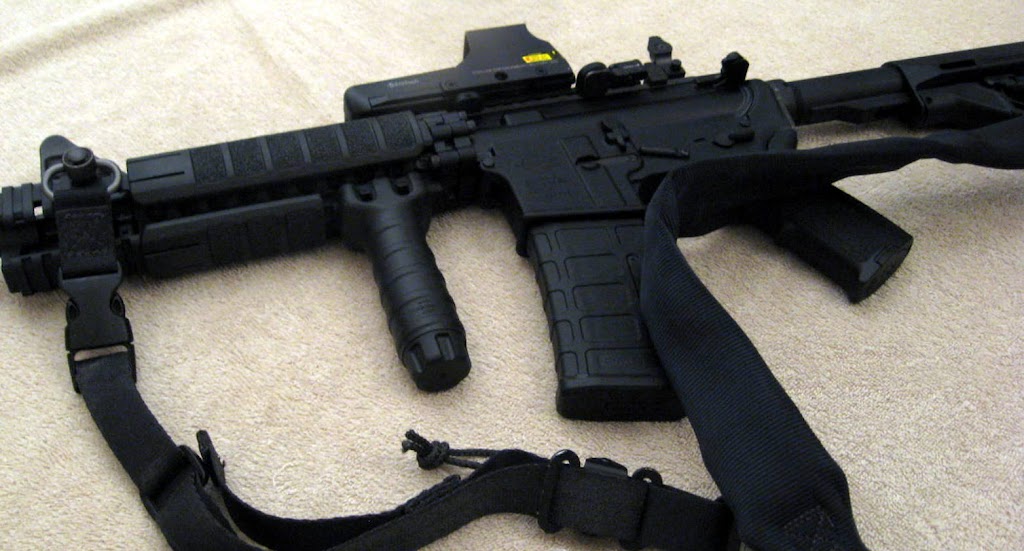

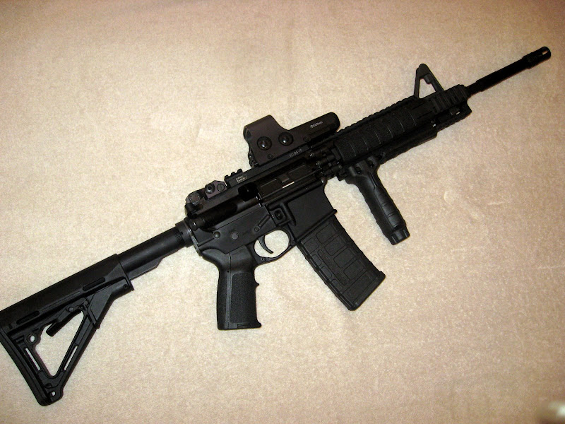

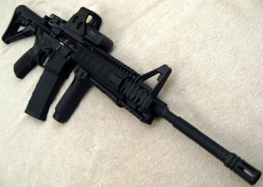

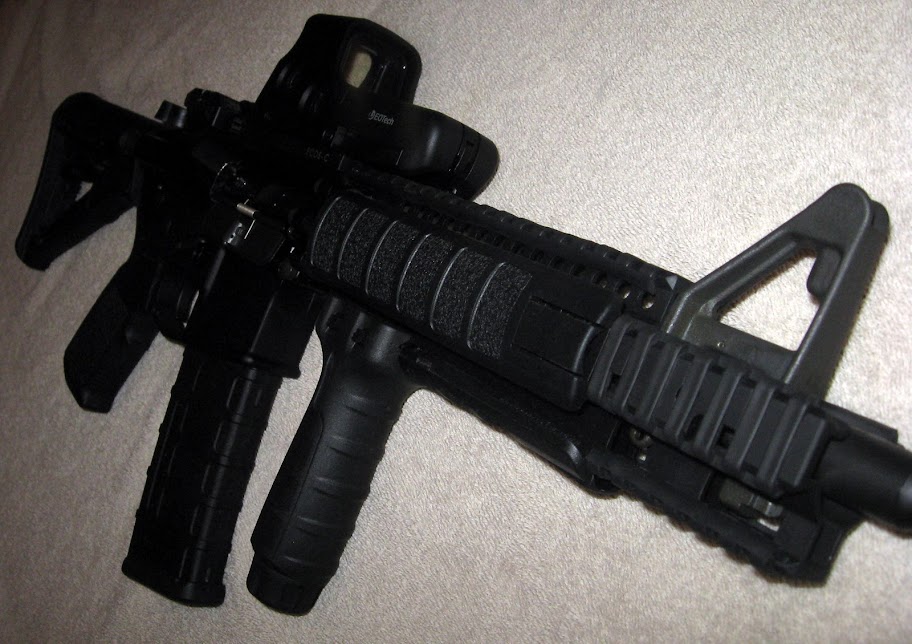

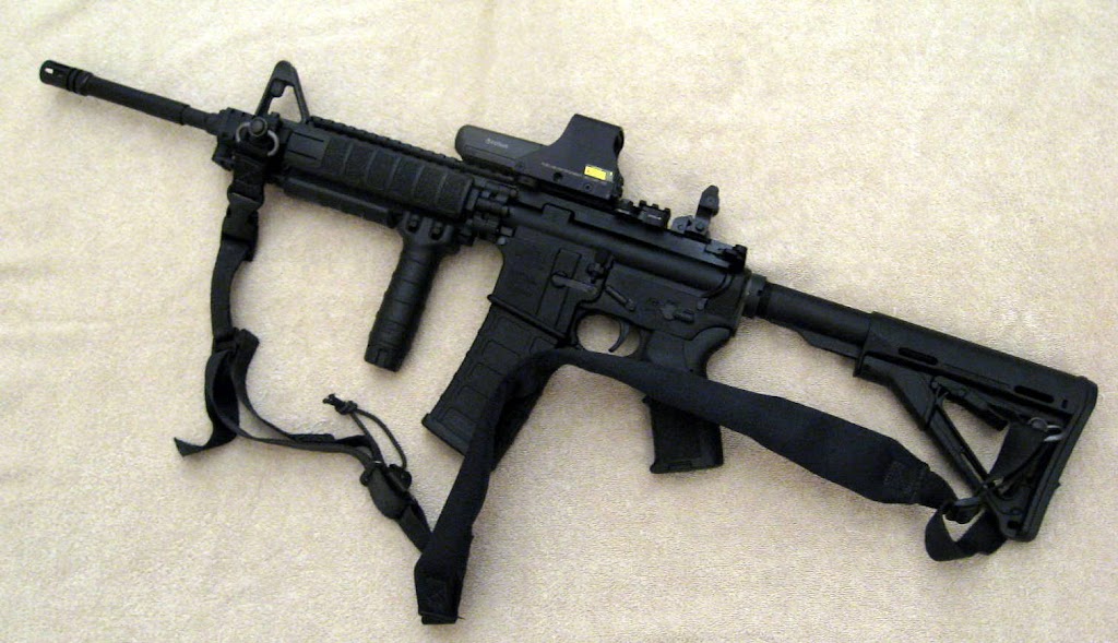

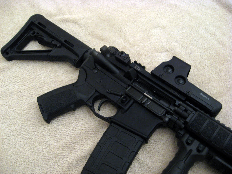

Rock River Lower
RR Lower Parts Kit w/ Two Stage NM trigger
Magpul MIAD and Aluminum Trigger Guard
Magpul CTR (Mil Spec Buffer Tube and Spring with H Buffer)
Daniel Defense 16" Complete Carbine Upper w/ the DD Lite Rail 9.5 FSP
Ion Bond BCM BCG
EOTech 552 sitting on a LaRue Riser (LT 110)
Troy Rear Folding BUIS
MI Rail Sling Adapter
Tango Down VFG and TD Panels
Viking Tactics LaRue Padded Sling
For some reason some of the images aren't working. Here is a link to the album.
I have a bipod but it isn't attached. Usually I run it w/o the VFG and instead I use a full sized TD panel on the bottom rail. I cut down the TD panel you see in the photos to fit the VFG.
I started lurking in the summer, and had it done by Christmas. 3,000 rounds down the pipe so far and loving it!

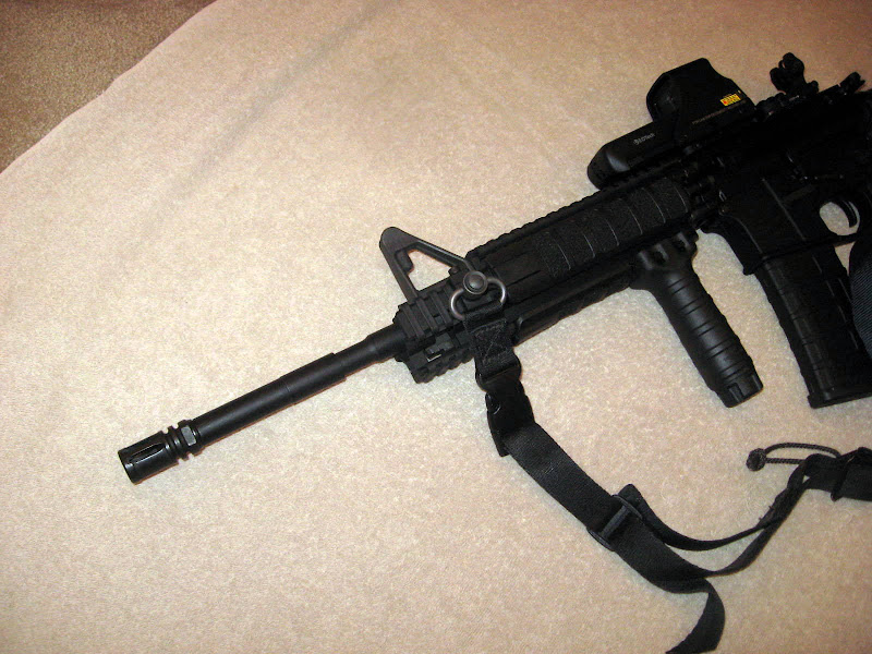

D.D. make there own Barrels?
2/28/2008 8:31:14 AM EDT
nice rifle ya got there...
2/28/2008 8:52:05 AM EDT
They don't make them in house. As far as I know they use Lothar Walther for their SPR models, but I never could find out who makes their carbine barrels. It's 4150 and chrome lined with 1/7 twist. They're also parkerized under the FSB.

First and foremost, thanks for all the complements guys.
How is the Eotech?  I have no experience with it only the CCO.
I like it quite a bit for the type of shooting I do, and plan to do. I'm not a big fan of shooting paper, and that's where I find I like it least, but it's great for plinking and even better for tactical shooting. Target acquisition is a breeze and reticle acquisition is instantaneous. The EOTech itself isn't perfect. The buttons work, but a knob (a la Aimpoint) gives better tactile feedback and quicker adjustments. I lucked out and got the 552 new for $320, otherwise I had planned to get the 512.
My only gripe with the optic setup I have is that I planned to use the LaRue Poor Boy, but I found that pushing the EOTech and its mount forward upset the balance of the rifle. The balance problem and the extra weight of the Poor Boy made the rifle a bit too cumbersome. As it stands the rifle weighs in at 8lbs empty, and that's right where I'd like to keep it. The only additional accessory I plan on acquiring is a light and mount.
You shot it yet?
Oh yeah, and what a blast it is! I've put about 1000 rounds of Rem UMC 55 grain through it, 500 rounds of some HSM Factory New SS-109, and 1500 rounds of Barnaul 62 grain. This thing eats up brass cased ammo like it's going out of style. There are occasional hiccups with the lacquer coated Barnaul stuff - but the ammo is relatively cheap so I let it slide.
