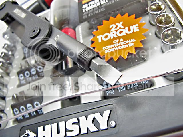

Magnetic ¼”
screwdriver bit holder

In addition, like all Gen2
Multitaskers, the TUBE has a male 8-32 thread, compatible with OTISTM
cleaning kits; this early preproduction model does not have the O-ring seals.

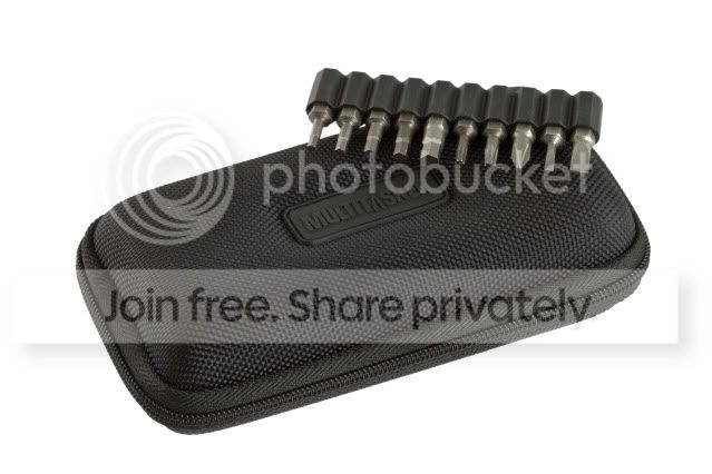

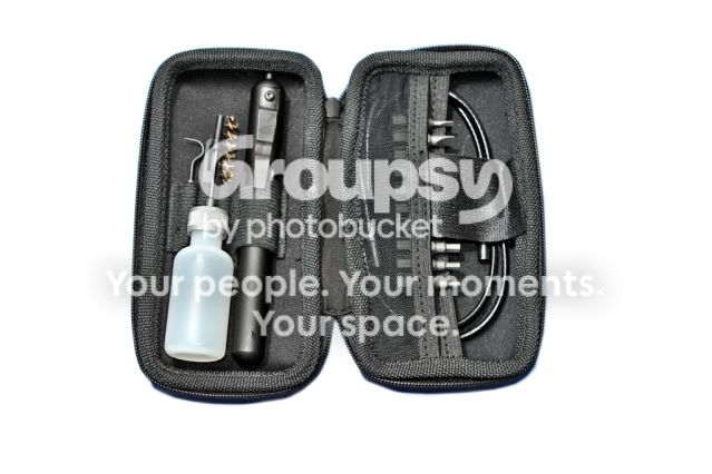

The optional Expansion Kit
is a handy zipper case, made from 1000D nylon and reinforced with EVA foam.
There is room inside for the TUBE, the dental pick (or carbon scraper) plus a
brush or patch holder, an Otis cable, and the included tool bit strip, which
contains 10 AR-specific ¼” screwdriver bits – these fit into the magnetic bit
holder of the TUBE. You can also use most std ¼” bits you find at the hardware
store, further increasing the utility of the TUBE.

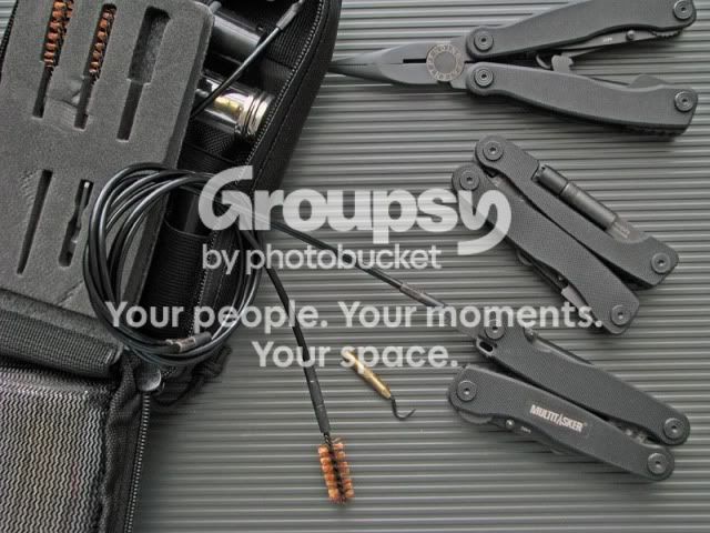

Here’s a TUBE with Expansion
Kit along with other accessories (photo courtesy of Ryo)

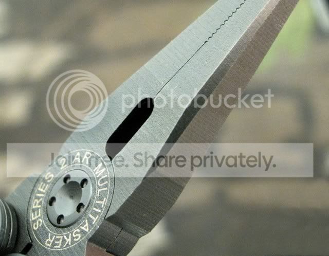

And these are no ordinary
pliers – unlike other multitools that have investment cast pliers, the pliers
on our Series2 are machined from solid billets of D2 tool steel. That’s right –
these are the first (and only) multitool pliers on the market that are CNC
machined from billet tool steel. Not only that, but they are fitted with dual
roller-bearings in the pivot for unrivaled smoothness. You have to try it to
believe how smooth and drag-free these pliers are. Bare D2 steel is prone to
rusting, so we treated these pliers with QPQ Tufftride – a salt bath nitriding
process similar to what Glock uses on their slides.

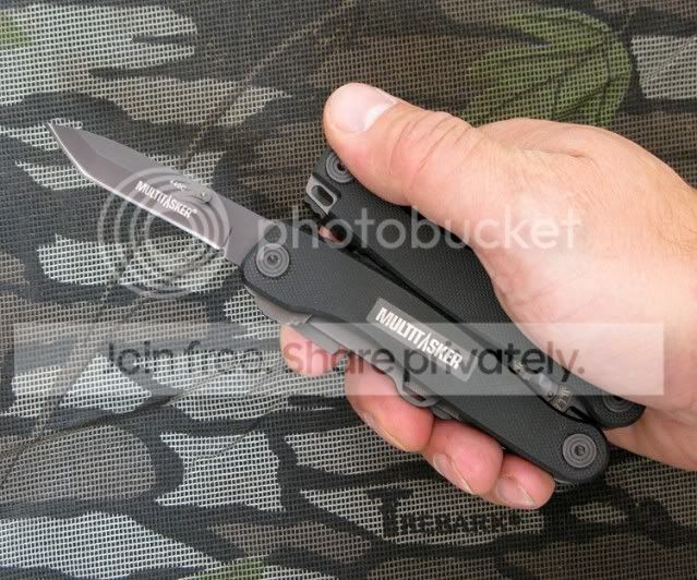

Like the original Gen1 AR
Multitasker, the handles are covered with our G10 Maxgrip scales. The G10 gives
you a nice non-slip grabbing surface under any conditions, try gripping a bare

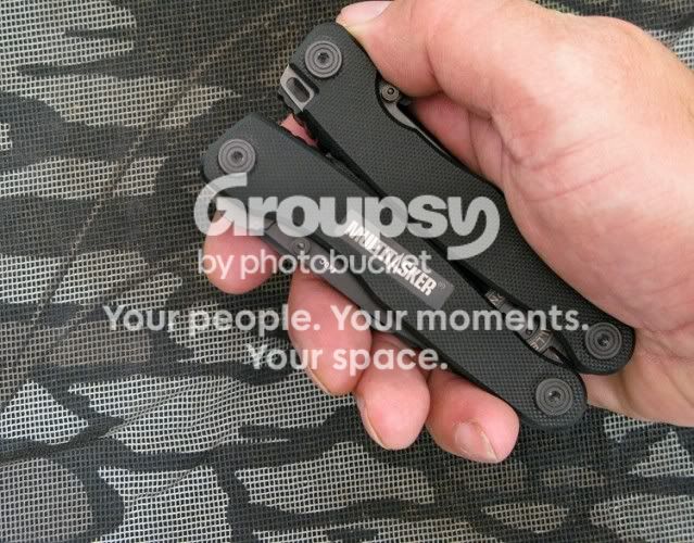

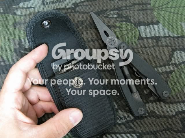

metal handle multi and you will notice the difference right away [photos
courtesy of J-Sews on Multitool.org].

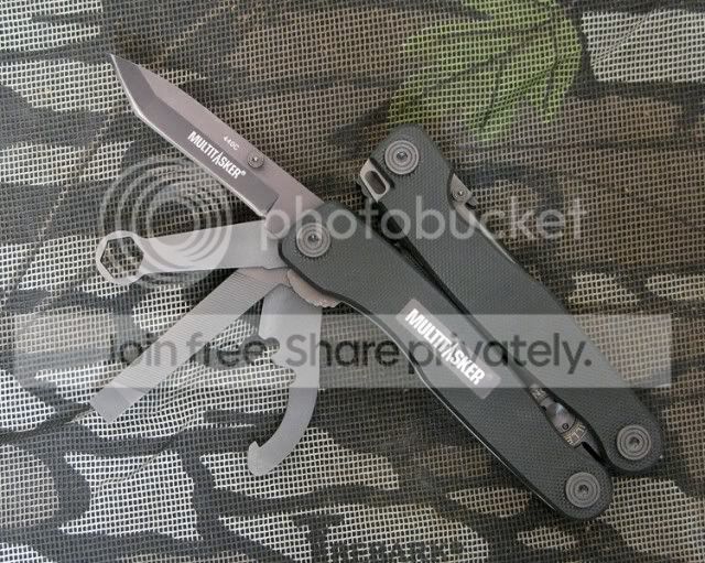

440C stainless Tanto-style
knife blade (2.5”) with a beefy liner lock

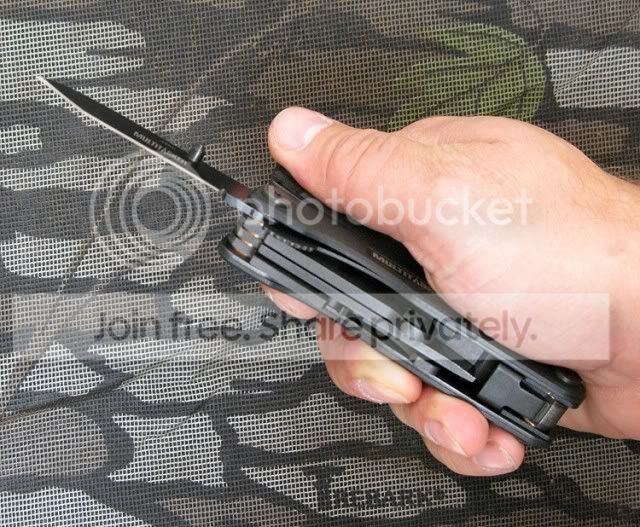

You’ll notice none of the
other tools "lock” in place – they actually snap into place with authority
thanks to a very beefy backspring, you have to exert significant force to fold them
back.

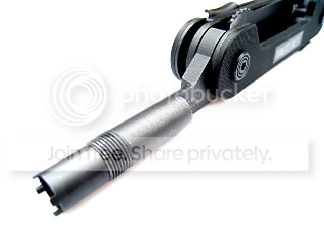

To put safety locks on the
other tools IN THIS CHASSIS would mean more weight and complexity ($$$).
Other unique AR-specific
tools found on the Series2 include a 3/8” box wrench for adjusting LaRue mount
tension and a spanner wrench for tightening unstaked castle nuts.
Use your thumb to hold the
wrench in place while you tighten down [photo courtesy of Stickman]

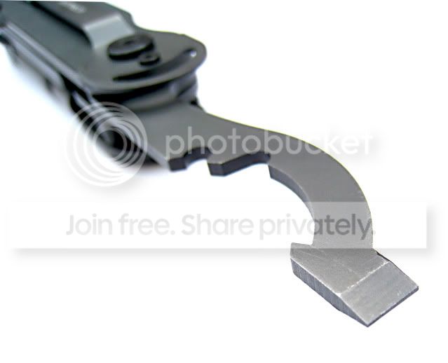

The file is actually a very
beefy flatblade screwdriver that is ideal for the TA51 ACOG mounts issued to
the military.
On the other side, you have
the incredibly useful and versatile bent-tip carbon scraper found on all
Multitaskers.

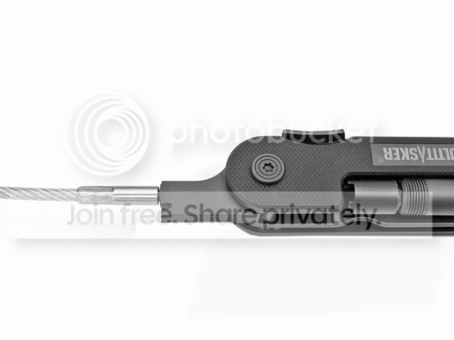

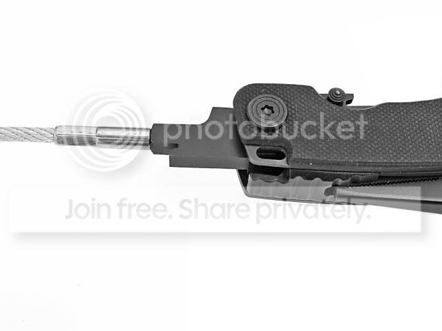

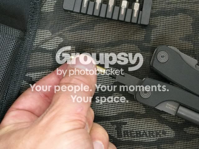

The dental pick unscrews to
reveal the 8-32 OTIS compatible male thread
[photo courtesy of Chako on
Multitool.org]

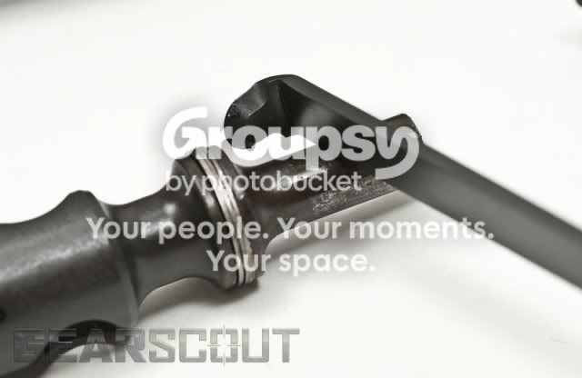

Rob Curtis from the
GearScout Blog on Army Times did a detailed comparison vs. the Leatherman MUT:
http://militarytimes.com/blogs/gearscout/2010/11/23/tool-fight-leatherman-mut-vs-multitasker-series-2/

The other is this BEAST of an armorer's wrench. The prototype was machined out of D2 billet in China, but I am trying to find a cost effective way to make it in the US. It ain't easy.
http://img571.imageshack.us/img571/119/wrench2.jpg
Um... might I suggest adding the holes and contour for a 3 prong FS wrench along an edge there somewhere...
