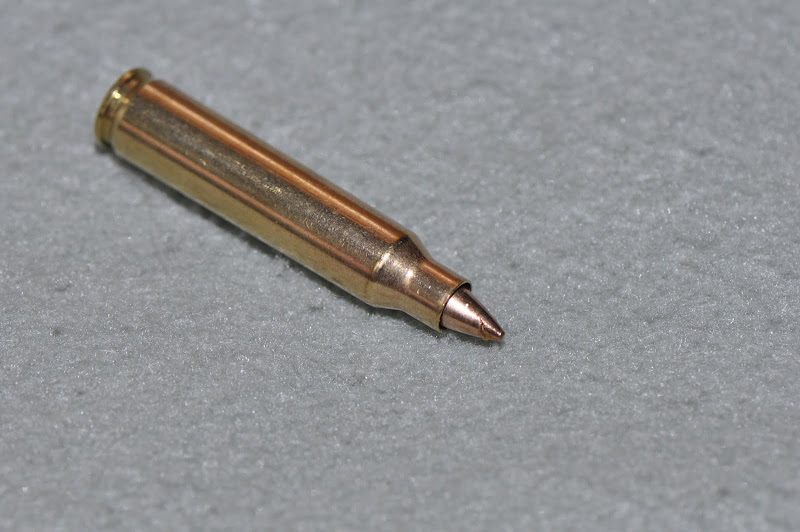

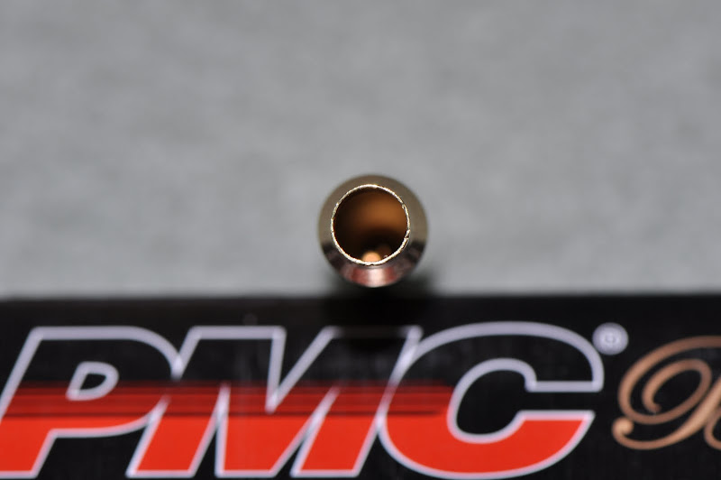

Before heading to the range today, I was loading magazines from a sealed case of PMC bronze (blaster ammo).
I found a round with a projectile pushed into the case and no powder.
I'm guessing the bullet was not concentric with the seating die and was pushed into the case, during subsequent processing
the powder was lost before packaging.
I have been loading my stand-by magazines with PMC XTAC because I'm a fan of the ss109.
Now, I'm worried that PMC seems to have no QC, and during an emergency, the first round I fire could be a squib.
(BTW, please don't make fun of me for how much I paid for the Bronze.  I bought it during the Obama ammo drought).

the powder may have fallen out.  if you push a bullet below the neck, the powder falls out.

Ammo companies make like 84 kazillion rounds a year.
Inevitably, some bad rounds slip through the cracks.
While unfortunate, it is reality.
I've seen ones like above, some with backward bullets, backward primers, split necks, torn necks, dented so bad they wouldn't chamber, no flash hole punched, etc...
If I would have gotten the round above, I would have tossed it over the berm and never given it a second thought.
The above round probably had the projectile pushed too far into the charged case during the manufacturing process and all  the powder got emptied during the subsequent handling operations.
And then the dude that was doing final QC saw the hot "new chick" walk by and got distracted momentarily.....
