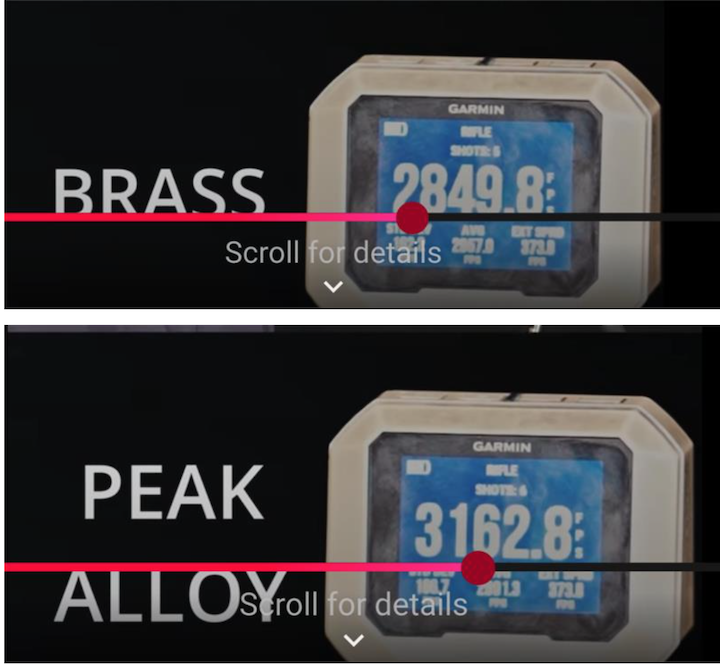

A 3rd option - and possibly the best option - is Federal's new PEAK alloy cases. Currently in use in the 7mm Backcountry, they have shown 5.56 test samples before.
https://x.com/teppoblog/status/1981240552428593169
G$ showed off the PEAK 5.56 in their guns (unknown if modified)
Federal’s Peak Alloy is changing ammo w/ 7mm BC. This case tech increases velocity w/ similar recoil
64gr from a 14.5" comparison
10/23/2025 8:57:07 AM EDT
Geissele posted this video of Peak alloy cased 5.56mm a while ago.
Federal 64gr Bonded picks up 300fps in a 14.5" barrel.
Cool stuff we will probably never see commercially.
eta: beat, didn't read past OP
