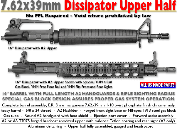

http://www.model1sales.com/images/products/udispre762.gif
the lower upper in the picture is what I purchased except instead of a railed block its low profile. When I ordered it I assumed i needed the low pro block to fit inside the free float rail.
Yeah the front low pro is useless. You might as well take it off.
