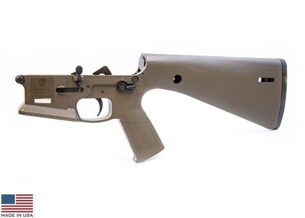

-Polymer AR lower ala GWACS/KE (takes 65 seconds to make; replaces multiple parts, speeds assembly)

Polymer lowers are a non-starter. They sound great, but the reality is that the US is littered with machine shops which could take a TDP and make a lower more or less to spec on little notice. Polymer is a pain in the ass to get right and you can't easily take molds and just start production elsewhere. I'm really not sure where Ian got the idea that it would be the path forward - on paper it sounds great but there's a reason mass-produced ARs still use aluminum lowers.
Otherwise concur with everything @Veprz said.
2/13/2023 12:53:45 AM EDT
Polymer AR lowers have been perfected for ~10 years now, first with GWACS and now the updated version from KE arms.
It's the single biggest savings for cost / materials use / production time / assembly time, as each mold can pop one out every 65 seconds, and it replaces multiple parts (Lower receiver, buffer tube, castle nut, stock, pistol grip, pistol grip screw.)
The AR already uses a polymer stock, grip, handguard, and magazine, so it's not like polymer is not already heavily in play.
For our WW3 scenario, we must also consider that the top countries for Aluminum manufacturing are China, Russia, and India. China and Russia are hostile powers in the WW3 context, and India is likely to have difficulty exporting raw materials in wartime.
We could see something similar to WW2, where Aluminum is considered a 'strategic material,' and rationed for top priority defense production (missiles and aircraft.)
In which case eliminating the aluminum of the lower receiver and buffer tube would be welcome.
That's one shop, which has the tribal knowledge.
Try scaling that up and you run into issues. I dealt with scaling polymer across multiple suppliers on a project which was even simpler. The only requirement was that parts from vendors 'A' 'B' and 'C' all had to match each other.
I remain incredibly unconvinced.

Wraithworks has a monolithic polymer UPPER.  Just over 5 lb AR for $800 on a KP-15.

Polymer lower?  No length of pull adjustment. Not mil-spec. Why?  A standard mil-spec lower with the ability to add whatever stock the mission or individual soldier requires or desires seems like a far better choice.

It's 'weapon of mass production,' which is a play on words, as we're optimizing the rifle to speed up production and lower costs in WW3 situation where millions of rifles are needed.
https://en.wikipedia.org/wiki/Mass_production
Most of the current Ukraine War is being fought with rifles with a fixed length of pull. The US, as recently as the invasion of Iraq, was using rifles with irons and fixed length of pull. Virtually every combatant the US has fought WW1-Syria has had a rifle with a fixed length of pull....
So for a WW3 'weapon of mass production' designed to rapidly arm millions of conscripts, a ~medium length fixed stock should suffice.

The GWACS/KP15 lower eliminates another 6-7 parts from manufacturing and assembly.
Across a 4 Million rifle production run, going with the Slick side upper + KP15 polymer = 68 million parts saved from production and assembly.

The kp15 lower is a no go, it requires cassette triggers (and anti walk pins)
Build a lower out of steel. Semi only, with a standard safety (much quicker to machine vs the FA one) integral trigger guard.
Use a standard car spring and weight, loose the retainer pin. Thats 2 parts you don't need.

Your entire 1st sentence is incorrect.  The KP-15 requires neither cassette triggers nor anti-walk pins.
https://kearms.americommerce.com/OD-Greeen-kp-15-complete-mil-spec-fcg.aspx
Complete Mil-Spec FCG Lowers Include:
   Mil-Spec FCG
   KP-15 Optimized Ambi Selector
   KP-15 Long Hammer Pin
   Carbine Buffer and Spring
   Buffer Detent Assembly
   Mil-Spec Mag Catch Assembly
   Bolt Catch Assembly
   KP-15 Take Down/Pivot Pins
   Buttplate
Technical Information
   The KP-15 receiver uses a Carbine buffer and spring. Do NOT use anything other than standard carbine buffers and round springs or the JP SCSS in the KP-15.
   The Take Down and Pivot Pins have the detents built into them; eliminating the spring and detent holes in the lower increases durability.
   The buffer detent (should you choose to use it) is held in place with a 5/64” Roll Pin
   The KP-15 is compatible with all Mil-Spec Fire Control Groups
   The KP-15 is compatible with cassette style match triggers including the KE Arms DMR and SLT units. The retention system of these triggers with D-Clips in the bushings to retain the fire control pins makes them better suited for use in the KP-15 than other designs that require captured pins.*
   The hammer pin area is wider for durability; Standard AR15 hammer pins can still be used but we offer a longer hammer pin for customers preferring a flush pin for aesthetic reasons.
2/14/2023 4:09:26 PM EDT
Huh. I could have sworn it did. Disregard the first part then

KE Arms offers a Kp-15 lower w/ their cassette trigger b/c not all cassette triggers will fit, and some cassette triggers may need KP-15 type anti-walk pins b/c of the lack of pin retention of cassette type trigger assemblies.
I absolutely agree w/ deleting the buffer retaining pin - particularly on a polymer lower.  Fixed triggerguard, short mild steel one piece tube handguard w/ integral bbl nut, makes your straight gas tube easy to do - though I suspect most of our ideas are a lot more expensive than Wraithworks' polymer upper, particularly since it could probably be printed.
I think the idea is to keep parts interchangeability with the existing stock of rifles w/o degrading performance or increasing weight too much.  The less machine time on the bbls the better - which adds weight.
