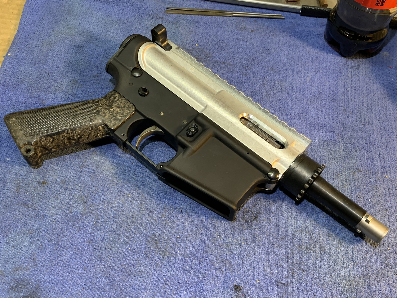

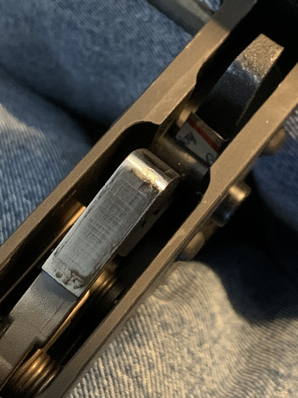

I started by using printed parts for the SS, but the failed before firing it. Tested the semiauto functionality last weekend and it was good to go. Got the metal trip plate and it didn’t work with a printed lever. With a metal lever it passes the bench test. Gonna try to get out tomorrow and live fire it.
Anderson lower.
RTB upper, conversion, barrel and plastic CH.
Supersafetyshop metal SS and aluminum trip sled.
The rest is parts bin parts.  I modded the trigger and detent and polished the SS drum and trip sled.  No AB weight, but I’ll take the one out of the ‘16 conversion just in case.

Just wanted to note that in the Bore Buddy info section on their website they note that the trip should be adjusted to activate the FRT just as the bolt closes. Not before or after. I have a Rare Breed in mine and at first I had the trip adjusted way too far forward. I carefully examined when the trigger releases the hammer but using one finger to pull the trigger, one to push the FRT lever and one on the hammer so I could see exactly when the hammer was activated. Once I figured that out, I went back and readjusted the trip and that’s what made my gun run well.
The firing pin channel has to be keep clean or you won’t get a good primer strike. If you shoot suppressed it’s even harder to keep it clean.
Just some tips. I can post pictures or whatever helps.

https://i.postimg.cc/PqzHzStB/IMG_3536.jpg
Preliminary testing in sub-zero weather this morning.  The printed ABW weight was a no-go.  Replaced it with the CMMG ABW from the ‘16 and managed some bursts with mini-mags, Federal bulk and Thunderbolts.  As the pistol got colder, it didn’t work.
I’m going to try polishing the moving parts a little more to reduce the friction.  I will also wait until it’s north of single digit temps.  It ran with and without the silencer as well.  This is looking promising despite the 4.5” barrel and metal SS parts that are not recommended.  More to come…
ETA: The TX22 , which has been flawless, was also choking in the cold.
Anderson lower.
I’m quoting my previous posts for continuity.
Polished the drum and face of the stainless hammer.  If you peek down past the hammer you can see a beer can shim that I used to tighten up the trip to time it better.  I also polished the tip of the selector detent.
Upon reassembly, the drum picked up a bunch of resistance that wasn’t there before the grip and detent spring were replaced.  I cut 1/8” off the detent spring and now it’s glass smooth with the drum rotation.  The cross bolt is still secure in each position.  Something y’all may want to consider with the Hoffman configuration.
Everything checks perfect on the bench.  I’ll try it again this weekend for live fire function.
https://i.postimg.cc/0yJh9ZN7/IMG-3547.jpg

No dice.  I’m going to try some more shim and see about polishing the contact surface on the trigger.  It’s not quite releasing the trigger in forced reset…really close though.
12/7/2025 12:40:34 PM EDT
If you're getting a good reset on the rearward travel of the bolt, one thing you can try is layering some tape on the rear of the trip cutout (to advance the timing of the trigger on bolt return). If that solves your problem, the BB SS adjustable trip kit could be a more permanent solution. It may require filing off the rear shelf to allow moving the trip forward in relation to the steel bar. I'd start with laying tape as a diagnostic, though.
12/7/2025 12:50:14 PM EDT
The reset is excellent.  I initially was going to start layering material on the trip bar, but decided to shim the slop out of the drum where the lever contacts it in the forward position (pictured above).  I’ll play around with it a little more today and see what happens.
