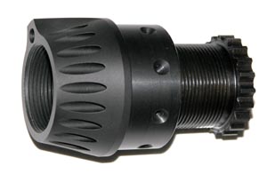

here is part of one of my prev post to see how the JP works,  couldnt send all of this in an IM
Sorry the pics suck,  spankin new high tech camera  ($350)  and trying to get takin pics right.
The 2 piece barrel nut.
You Locktite this piece on
Thie piece wedges the barrel in,
hmmm
Pics with tube on upper,   Sorry no barrel,  Gotta go to Cisco to use an upper clamp.
Heres some pics from JP's Website,
