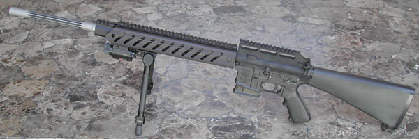

For a bench/varmint gun, you don't need a LaRue forend.
The Badger flat-bottom model would be a MUCH better setup to ride a bag with.
Here is a fluted Krieger barrel in a Badger handguard that I did a couple years ago.

Flat bottomed Badger Stabilizer runs $160.
That perticular one in the picture has the angled slots on the side, but the regular models will have horizontal slots.
I'm not convinced that the LaRue upper will help accuracy as much as spending an extra $125 towards a better barrel or scope would.
