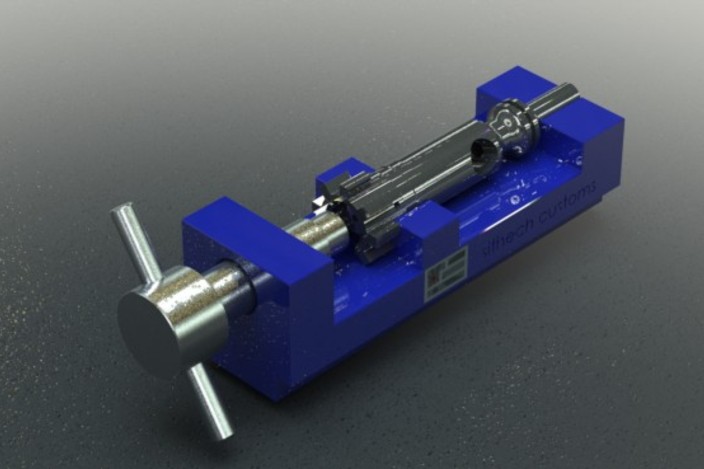

3/2/2015 9:32:17 PM EDT
The barrel extension is black. As far as removing the extractor... For the life of me, I could not not beat the roll pin out. I damaged a few roll pin punches trying.
I've already started a post in Rainier Arm's forum. I'm just waiting to hear what they say.
