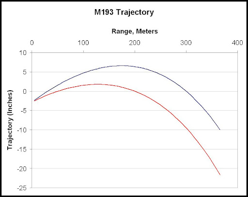

Sounds fairly normal.  Here's a picture to show what you are experiencing:
11/24/2012 4:24:27 PM EDT
That is about where a 25 yard zero will put you.  A 50 yard zero will put you about 1.5" high at 100 yards.
Posted Via AR15.Com Mobile
I used nikons ballistic calculator and it said sight .7" low at 25 yards for zero at 100.  I will try the 50 yard sight at 1.5" high tomorrow.

I always use this chart: and sight in at 50 yards.
