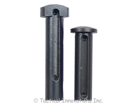

i'mn a newbie and I either misplaced or didnt get one spring.  Now looking at it everything functions like it should but not sure if i put everything right.  I still havent put the front take down pin or the bolt release yet. Is the front take down pin longer then the rear?
1/1/2013 7:36:12 PM EDT
Yes the front pivot pin is a little longer than the rear takedown pin.  The pivot (front) pin has a D shaped head and the rear pin is round.

Do you mean that the takedown/pivot pins themselves are the same, or were you referring to the takedown pin detents being the same?
For reference, these are the takedown and pivot pins.  The front, or pivot pin is longer and has the D-shaped head.
